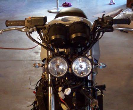

        Here are mine fitted with the stock brackets and turns.
        Here are the mods needed to make the work.
        I added 4 sleeves to the stock mounting brackets and got 30mm m6 bolts to replace the stock. I also took out the center sleeve and added a few washers.
        My plans are to black it all flat black when im done.
        Wires are next...

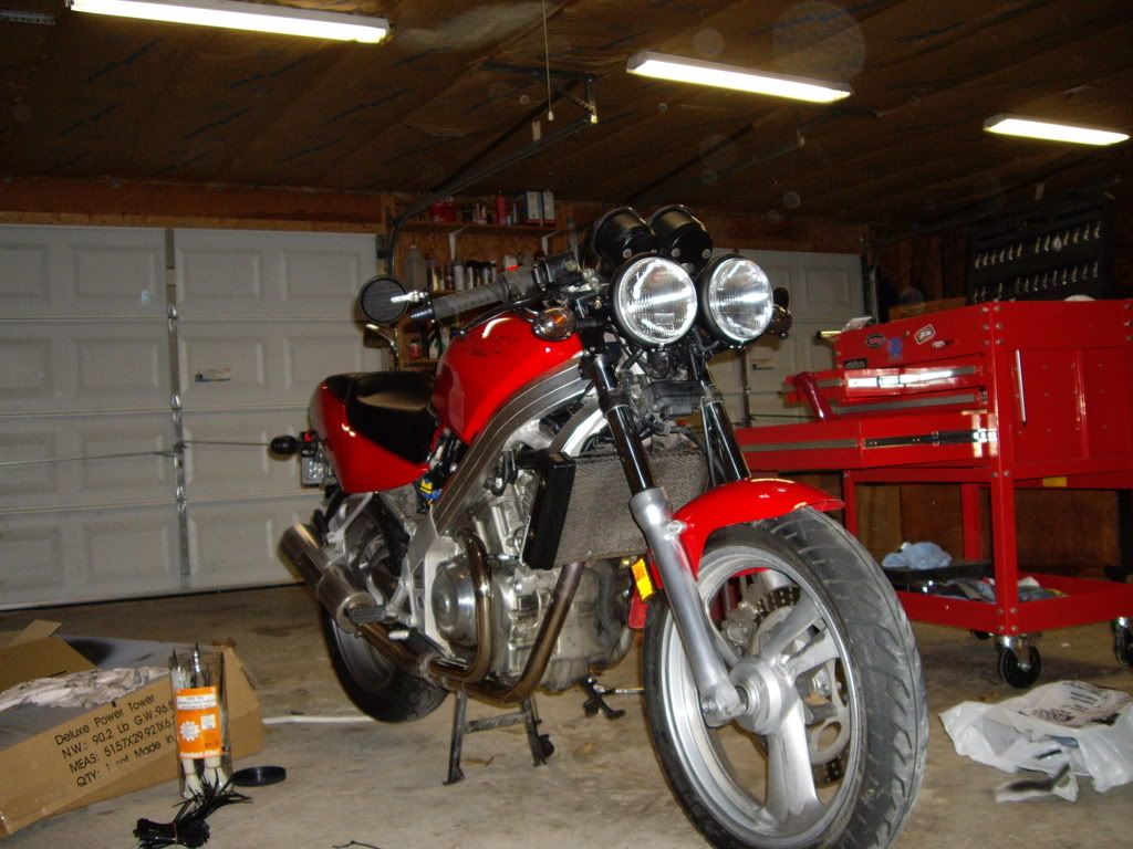

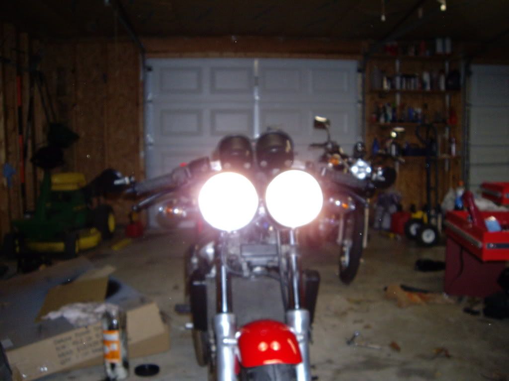

                  I finally figured out how to post the pictures. The install was rather straight forward. I used the relay kit and it makes the lights much brighter than stock. I figured out that the blue wire from the stock head light plug goes to the yellow wire from the kit, the white wire from the stock headlightt plug goes to the white wire from the kit and the green wire from the stock headlight plug is the ground. Let me know if anyone needs help with the install. I'm in no way a professional but I can try to help in any way possible.
