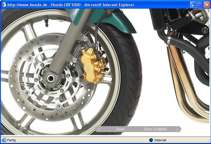

          Or you search for a nice Honda stock 3 pot caliper , this one , it is from a CBF 1000 (SC??) and fits into the HAWK without any changes

                            Has anybody tried the 3-pot Nissin in the CBF1000 photo? It does look like it could be a direct bolt-on for the Hawk...anybody know of any other bikes that use this one?
