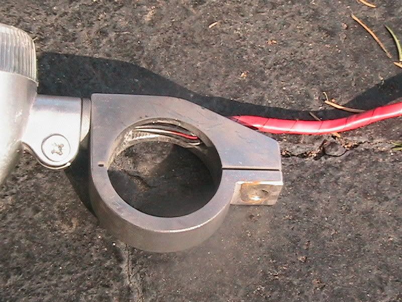

        Front signal mounts. I machined a clamp bracket to replace the droopy stock front signal mounts. Solid stainless steel. Good thing its not too thick. I run aftermarket signal housings with 2-colour LED lights with clear lenses.

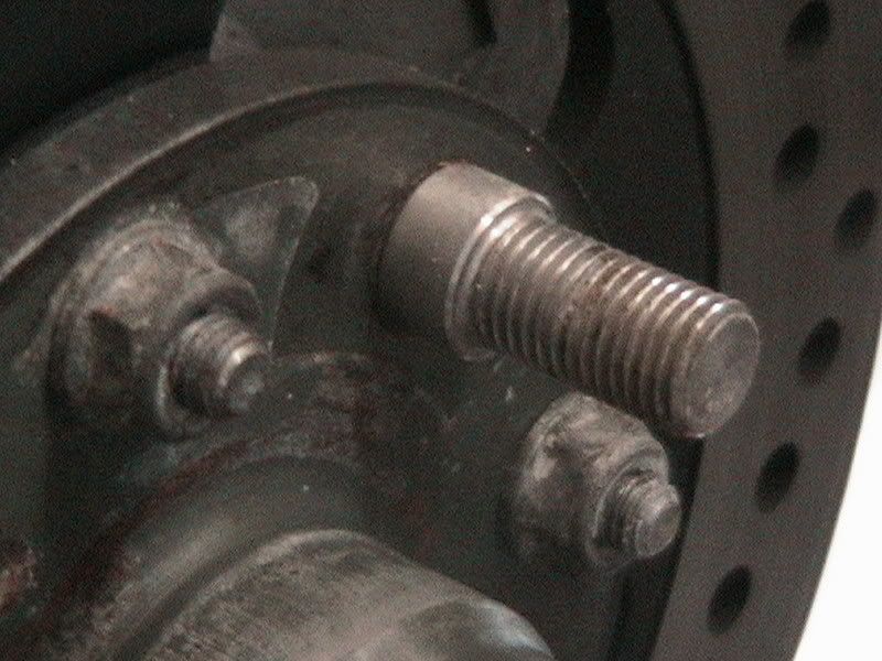

        2-piece VFR wheel studs. Allows me to run a VFR rear rim on an un-modified Hawk spindle. Can also change back again to stock Hawk rim if I want to.

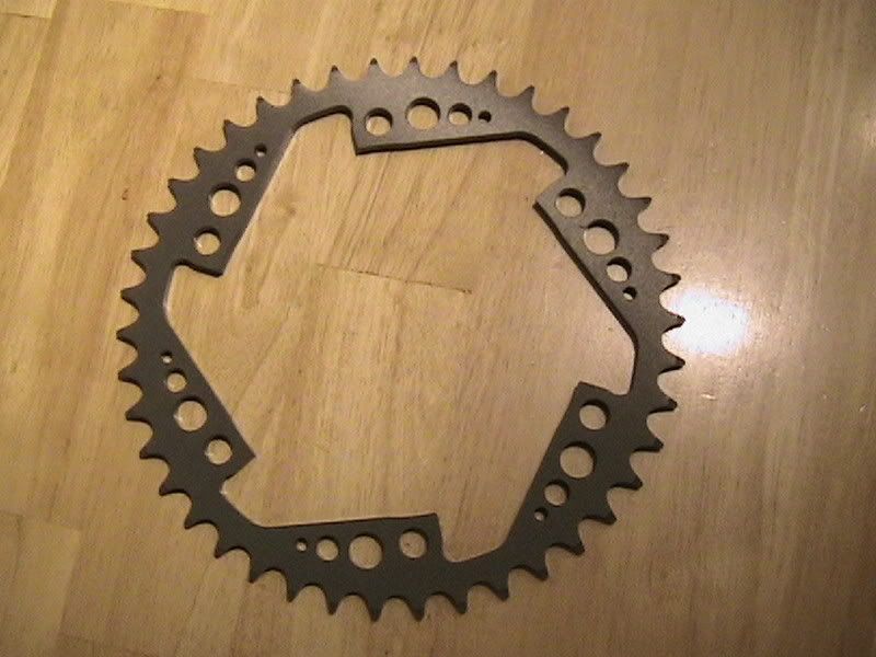

        42T 520 Custom rear sprocket. Made from a Sprocket Specialists 7075 Aluminum sprocket blank, then hard anodized.

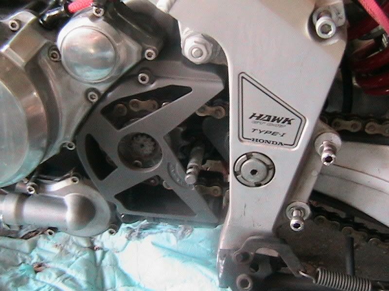

        Sprocket cover:
