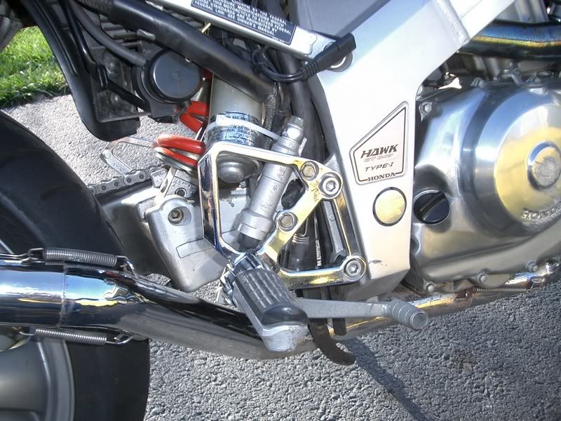

              Just posted this on Speedzilla but thought I should at least post here as well...
              Just wanted to spread the word (unless it's already been done) that rearsets from a CBR F1 will bolt on the Hawk just as easily as the F2 ones. I mistakingly bid (and won) a set on ebay and was about to cancel the purchase since he labeled them as F2 pegs but thought I'd give it a shot. Besides a little boring out of the mounting holes, they go right on as easily as F2 rearsets. I attached pics of the finished install for reference. I didn't know they were off an F1 untill a friend clued me in. Now you have one more set of frankenparts you can search for on ebay...

                nice upside down shifter
                  Gettin it ready for a track day...
