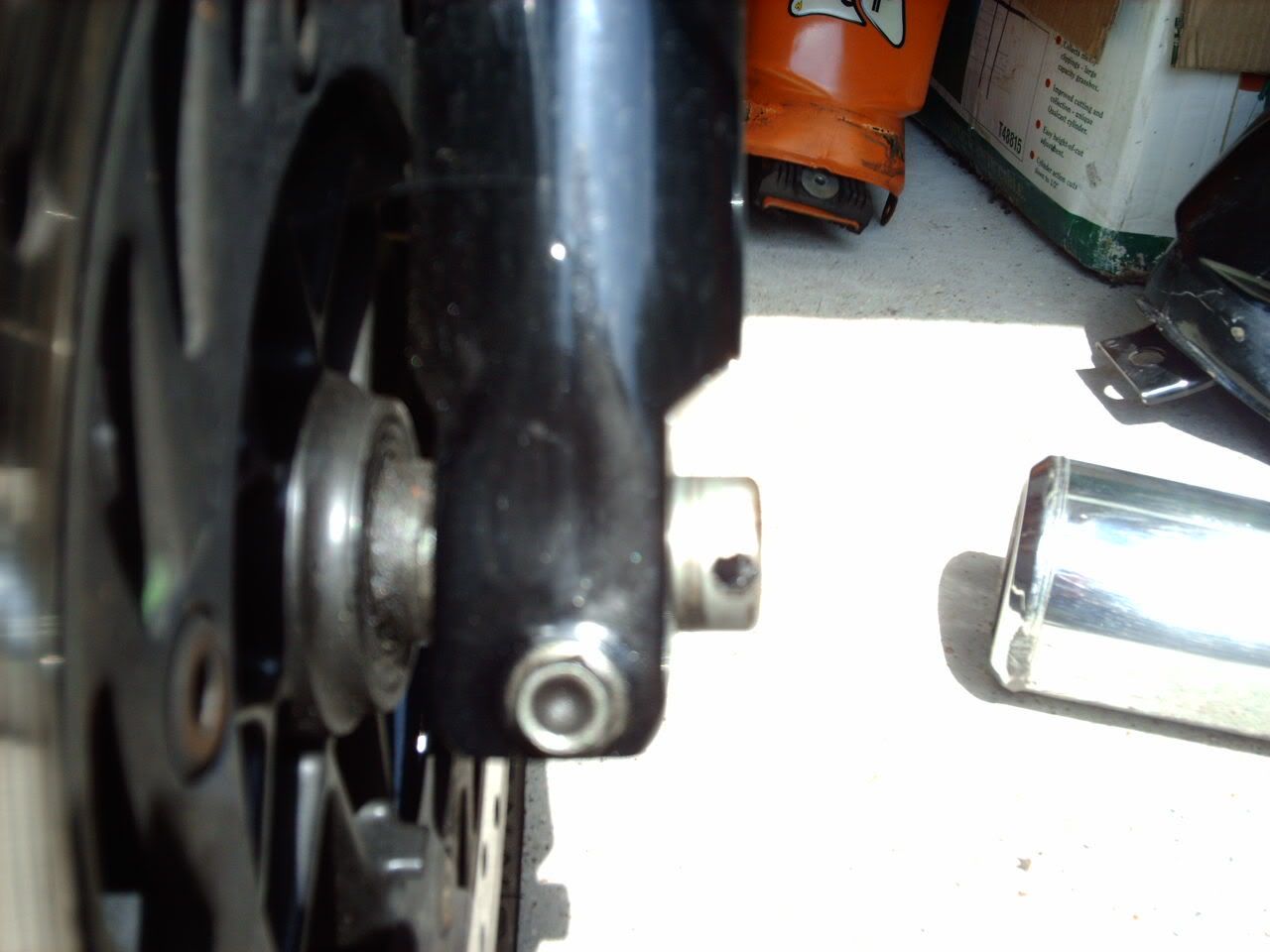

    this is the vfr 750 front end, with a bros yoke(triple tree) as you can see the spindle mark wont line up as the vfr yokes are wider! he had referbed the ''as he called them'' (gold nissan) calipers, but the disks were scrap and the front wheel had bad rim damaged so that was scrap too! so i managed to sell the forks and calipers and actually financed a f2 front end complete!

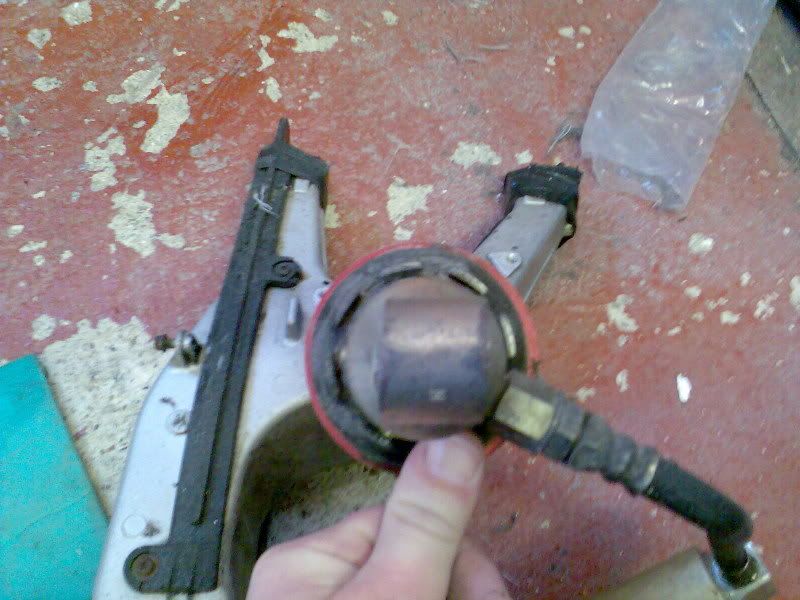

    wanna run a 190 rear tyre? fed up with it rubbing the swing arm? then use an angle grinder! yes this swinger has been butchered!

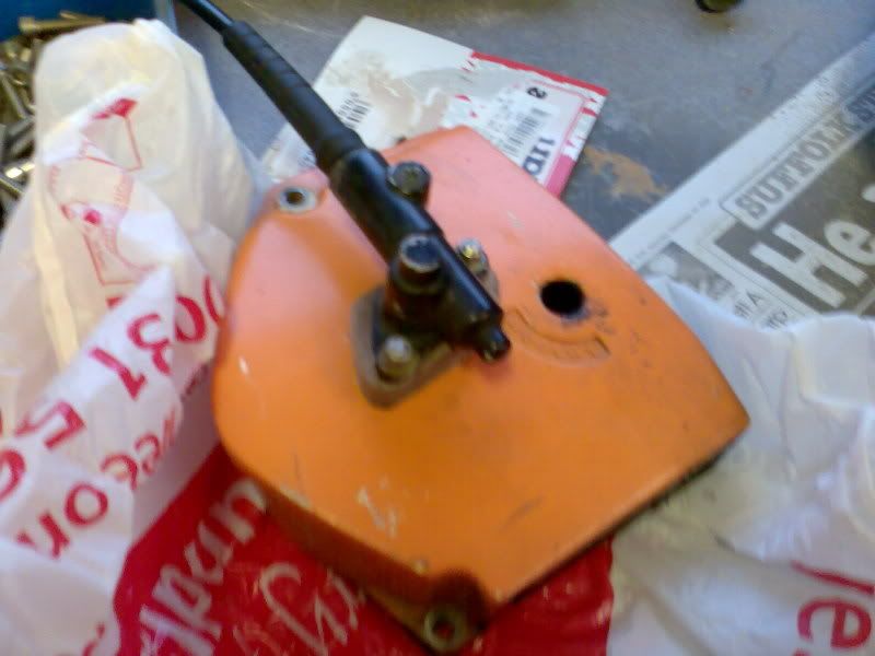

    one of the mods he was really proud of was his nc30 speedo drive converstion! as the vfr 750 front end didnt have a drive, he had an idea of driving the speedo off the front sprocket! on the side of the gear lever case was a speedo drive from an nc this was bolted onto a spacer he had cast from epoxy mixed with flour ! to which i was informed was driven by a nut welded on the end of the countershaft! take a look at what i found!

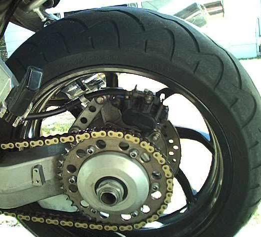

    you couldnt remove the sprocket as the weld had spilled over the end of the shaft but after 4 hours and many wheels of grinding with a dremmel i managed to save the shaft! i couldnt work out why he could only get one bolt in the sprocket retainer and tack welded it on? heres why!
    if any one has any idea why you would want to weld(i use the word WELD losely!) something like that on the back of your sprocket please enlighten me!

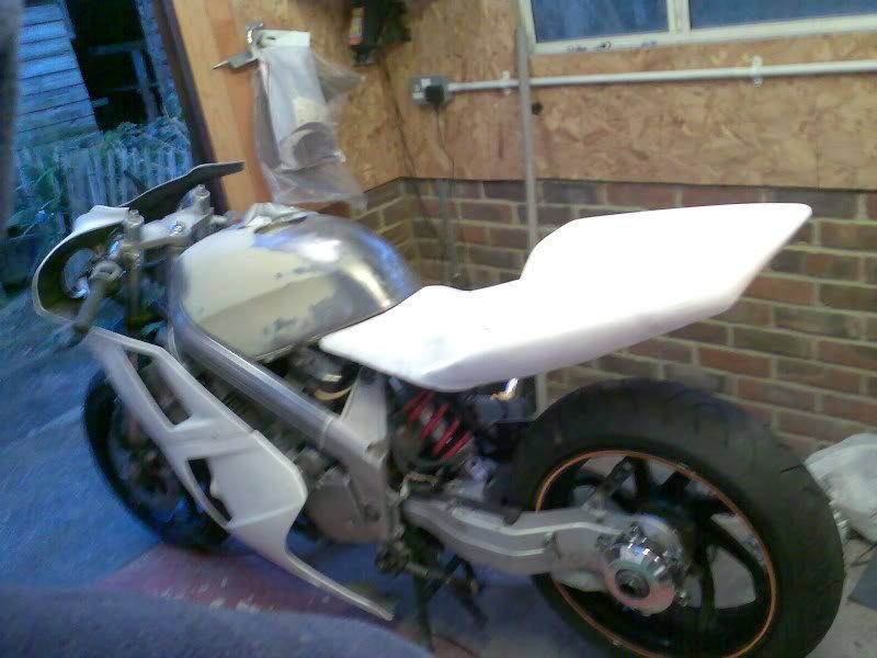

    anyway thats the story so far, hope its kept you amused for a while and watch this space to see this poor dog of a bike rise out of my workshop as a fully faired road legal track day weapon!

                  any one got a spare hawk/bros spindle they can have a measure up for me?
                  i need to know if this VFR750 spindle is the same length etc as a standard one as it looks like buying a new sprocket carrier and cush drive may be a simpler way to go!

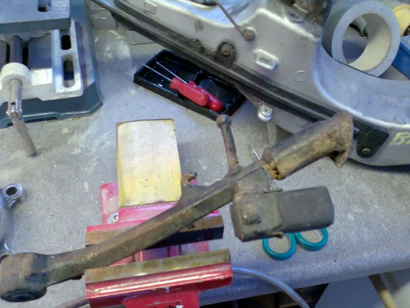

                    this is my favourite mod! he had fitted a longer shocker at some stage and had to modify the side stand so it didnt topple over! look at the quality!

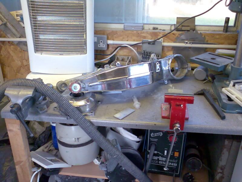

                    ive now got a new to me bros hub and spindle which has been kindly modified by my mate Squirrel for 6 bottles of stella!
                    apparently when you fit a 900 rr shock the top eye is a bit wide so needs machining down?
                    more angle grinder finesse? and yes it is wonky!
                    anyway this is where i am at the mo, sorry for the bad camera phone pics!

                            Rob,
                            not sure you got an answer to your hub question, but I've
                            just checked my original hub and it measure 168mm from
                            the same ref points you used.
                            From what I've read/heard you can use the VFR hub but you
                            either need to continue the thread by finding a specialist
                            machine shop to grind the thread, or the simplest option
                            is to have a spacer made.
                              cheers JR, ive junked the vfr spindle and got a bros one. complete with hub! so now chain and sprockets are not a problem! All the machining has been done for 6 bottles of stella, ready for my new 5 spoke wheel which is being newly powder coated by the seller as hes just scratched the paint getting the tyre off!
