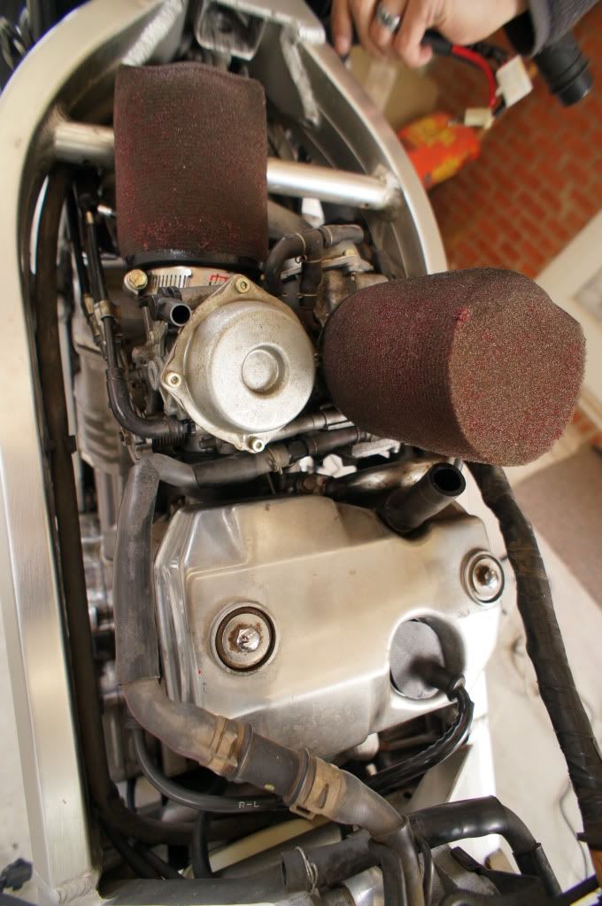

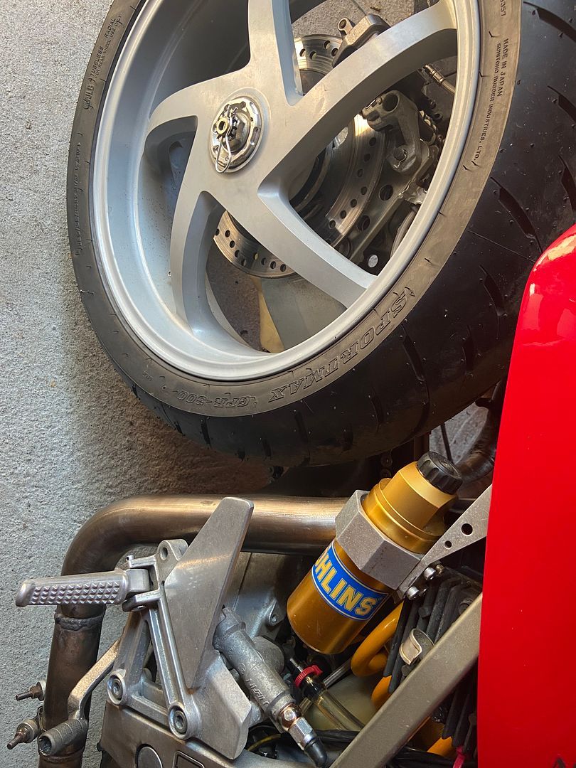

    I'll submit mine to the HOTM!!!! It's been so long I never got a chance to submit mine originally.
    1988 Honda Hawk GT, 14550 miles. Owned since late 2000s.
    Mods:
    - Stage Two Carb with foam filters
    - Ohlins rear shock
    - MotoGadget Motoscope Light (mounted by handmade custom fiberglass 5-ply mount)
    - TBR left exit full exhaust
    - Frame sliders with TBR adapter
    - VFR750 8-spoke Rear wheel
    - CBR600RR Front End (2007) - (install by myself and a friend (pictures in build thread below, with tons of advice from oldies here especially El Capitan and melmsrt4)
    - relocated choke to left side on frame
    - "infamous" Couch upholstered seat

      Originally Posted by joel View Post
      Only because it’s also a red Hawk with a left exit exhaust,Öhlins shock and USD front end.
