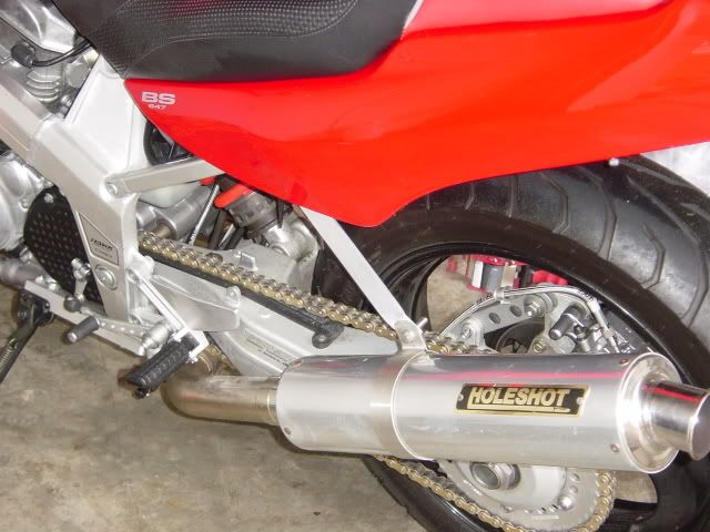

                I have a hole shot lefty and also the extender that Joel was talking about. It just so happens that I also made a bracket to hang my exhaust. Its just a piece of 1 inch aluminum bent and drilled. I made it with simple hand tools, and it works great. Heres a pic.
