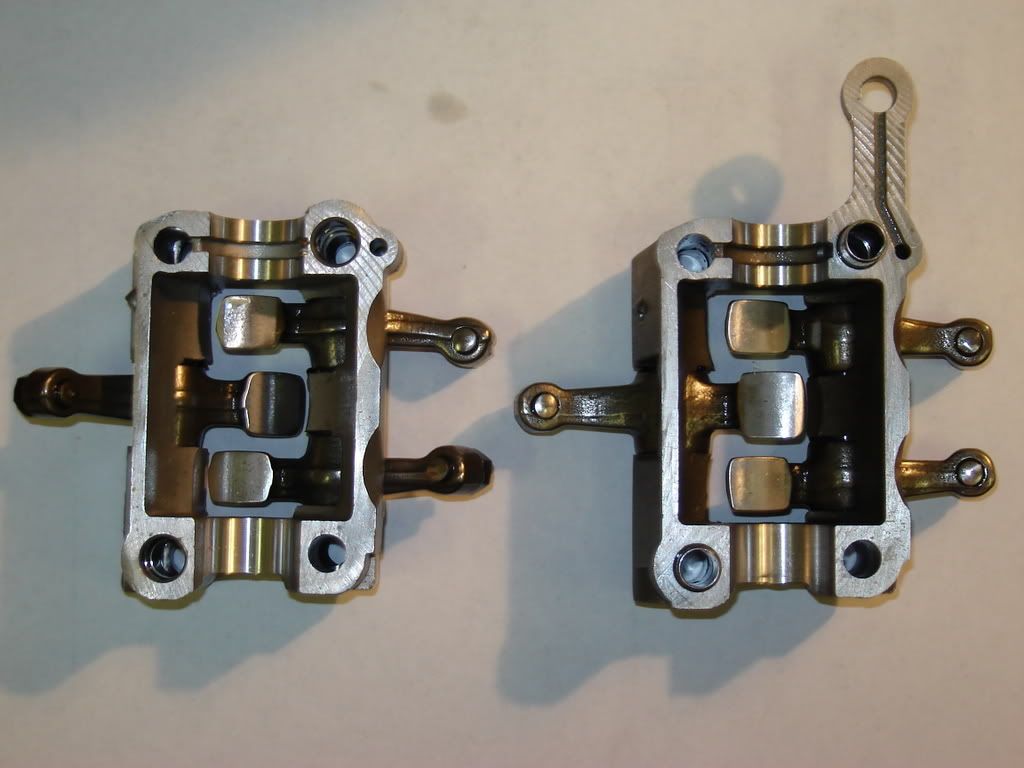

    I need a front head for an 88 motor. Like an idiot I did not think the heads changed between the years and so I bought one for 11 bucks on ebay ( 30 bucks shipping of course ). It is actually in pretty good shape but ... here is my cam holder ( left ) vs. the one I got ( right )

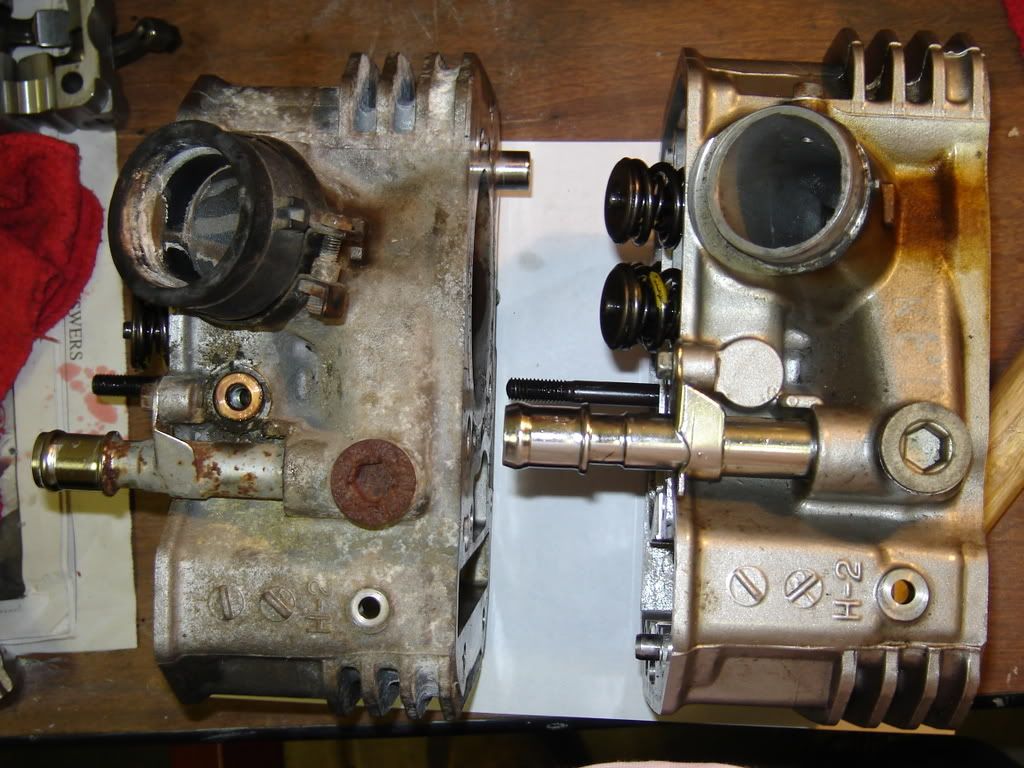

    so ok it has an extra oil passage is that a big deal? I am thinking.... then I looked for the oil pipe connector on my "new" head. My orig 88, which looks like it has been in the ocean for a while on left and the one I got on ebay on the right
    ruh roh! no oil pipe connector, it is where the brass washer is near the intake port on the left head. From a little research I think the ebay head is a 91 that had no oil pipe? It pumped oil up a hollow stud I am guessing. The 88 stud is solid. Anyway I am guessing there is no reasonable way to get this head to work on my 88 motor. If anyone knows a way to make it work let me know. So in my new new search for a front head, should I look for 88's only or will an 89 or 90 will work? I know the oil pipes are different between 88 and all others.

      I see no reasonable way to make this head work on an 88 bottom end unless someone with more info lets me know different. I think you would have to machine it to add the input for the oil pipe or alter the bottom end of the 88, both of which I would prefer to avoid.

            Thanks guys. I just realized I could look at the parts fiche. Duh. It looks like the 88-90 are the same parts, head casting, cam holder... etc. Same part numbers and all. 91 head is a different beast altogether apparently. Not sure why they went through the trouble in the last year.

                Kip is right, the 1991 is an altogether different bird. (as far as oil routing) If you were bored and had access to a mill, the 1991 heads could be made to work on 88-90. Check out the intake ports Kip, see how different the 91's are? They are a lot better I think, a flatter floor and nicer short side radius where it turns to the valve.
                Actually there are also some very small differences between 88 and 89-90, but they really aren't worth worrying about. Like how the oil line is fastened to the side of the engine, the output shaft seal retainer, etc.
                From what I have seen all the 650 engines still in production use the internal head oiling first seen on our '91's. I guess it makes sense, one less thing to go wrong.
