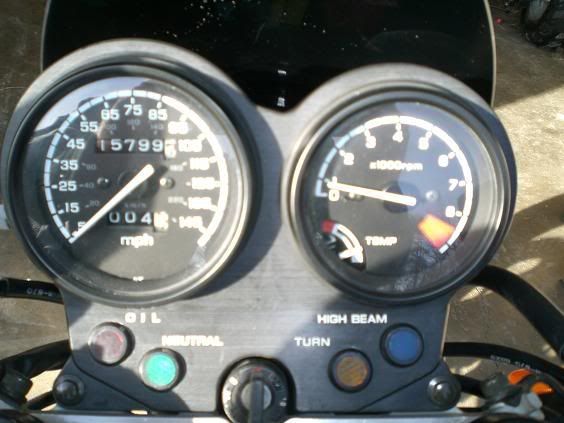

    before ride:
    and after 2 miles:

      I think you are right. When I took the above pictures the temp was about 55F, I got home from work today and it was 75F so I took the hawk out and it ran perfect. (14 miles)
      I let the bike cool down for a couple of hours then started it but this time I held the lower radiator outlet with my hand. After about 2 minutes I could fell it heating up. SOO I'm going to stop by the dealership tomorrow to get a new thermostat.
