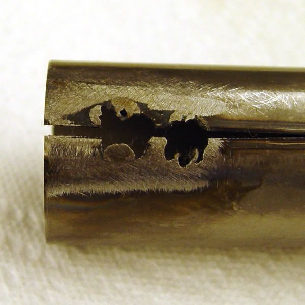

    I tore my forkss down this weekend and on the fork that was leaking I found the "SPRING COLLAR" had several holes worn in it and all of the fork oil was "gray" color instead of the other forks red color. What would have casued the collar to wear like this?
    I will post a pic tomorrow morning when i get to work.
    I am guessing I need to replace this part now...
    Looks like someone tried to weld it for some reason?
      That is not good.
      The good news is you can replace it cheap with a same size piece of PVC pipe. Maybe a little longer for some extra preload.
        OK i was wondering if I could do that. The stock piece runs like $15.
        If I replace one i guess I should replace both.
        Is this also the piece that gets longer if I cut my springs down?
          Check what it was rubbing on as well. (Inside of upper tube?) Weld material can be very hard and abrasive. Hope it isnt as bad as it looks.
          Red colour? Normal fork oil is amber, isnt it? It gets a little grey as the teflon wears off the seals. Bad forks have dark grey sludge in them. Red oil might mean someone has put in aircraft hydraulic oil

                    Also found my collar bushings were mostly copper... the service manual says to replace them if they are more copper than teflon.
                    If i don't change them whats it gonna do?
                      Give a lot more friction (called stiction when refered to forks) when the stanchion moves up and down. The teflon is designed to give minimum friction when sliding up and down on the chrome of the stanchion.
                      Dont skimp on changing them as they are cheap and you REALLY dont want to have to strip them all the way back down to change it...
                        I ordered a pair
