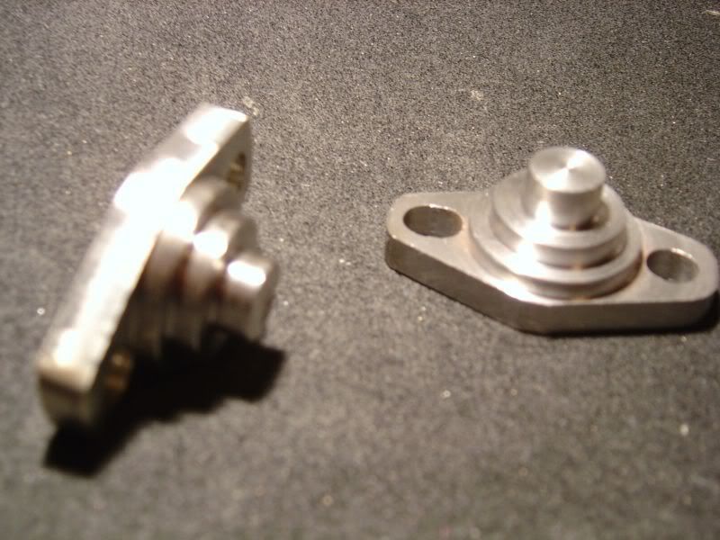

    OK. I got as far as removing all the smog related equipment except for that ugly pump on the side of the motor. What do I do with the two metal tubes leading to each head? Do I cap them off or let them breath?
    Welcome!
    I am no expert on this, so hopefully someone with more knowledge will give you more specific info but... I got a 91 CA head from ebay that had ASV on it and the ASV pipe was welded shut about an inch down. I am thinking you will want to cap it somehow otherwise you will have an exhaust leak out the ASV pipe. I can send you a pic if that helps.
      your gonna need some of these made:-
      and here is some instructions:-

        If the motor is still assembled just cap them off. If you have the heads off the motor then by all means give it to your local welder and have him close em up. I have a set of California heads that came from somewhere, (yeah they made it all the way to the east coast) when I get down to my welder I will have him close them up and after a little weld clean up they will be 49 state heads. By the way if anyone needs heads (or anyuthing else for that matter) let me know.
          Awesome information JR.
            thanks guys, I'll just cap them off for now. I'll post pics of the bike when I'm all done.
