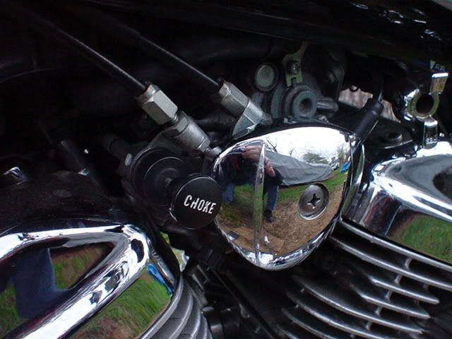

          How about a early Shadow VLX setup?
          Its part number 5 on the diagram
          It mount to the side of the engine, but you could get creative.
            hmm....could be a viable option
