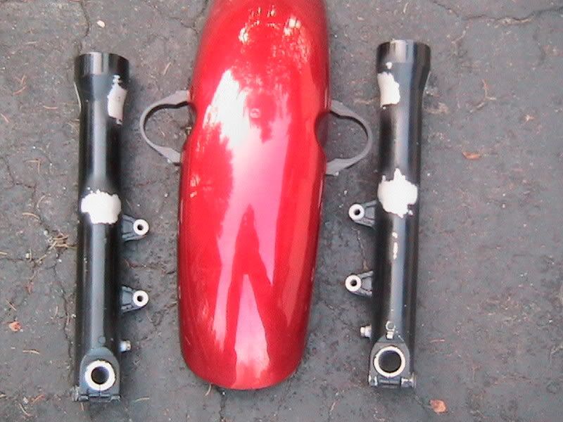

                I went the hard way.
                I cut and filed the f'ing lugs clean off of the F2 lowers and machined 2 half round clamps that have the same style as the cast mount on the Hawk lowers. Will post pic.
                  my Hawk fender anf F2 front forks:
                  [/img]
                    hum i like how it would look put together
                    does the fender get pulled out much?
                      The fender does not get pulled out of shape at all.
                      The forks are of course on the same centerline, the clamps have enough 'offset' to match the outside dimension of the fender. The fender has the steel frame with the tapped holes inside.
