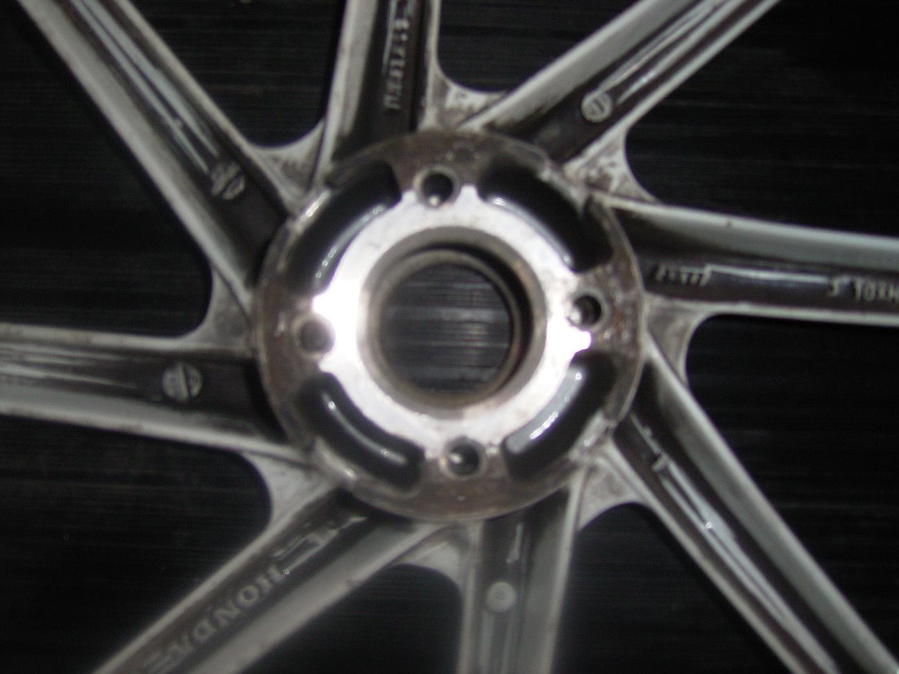

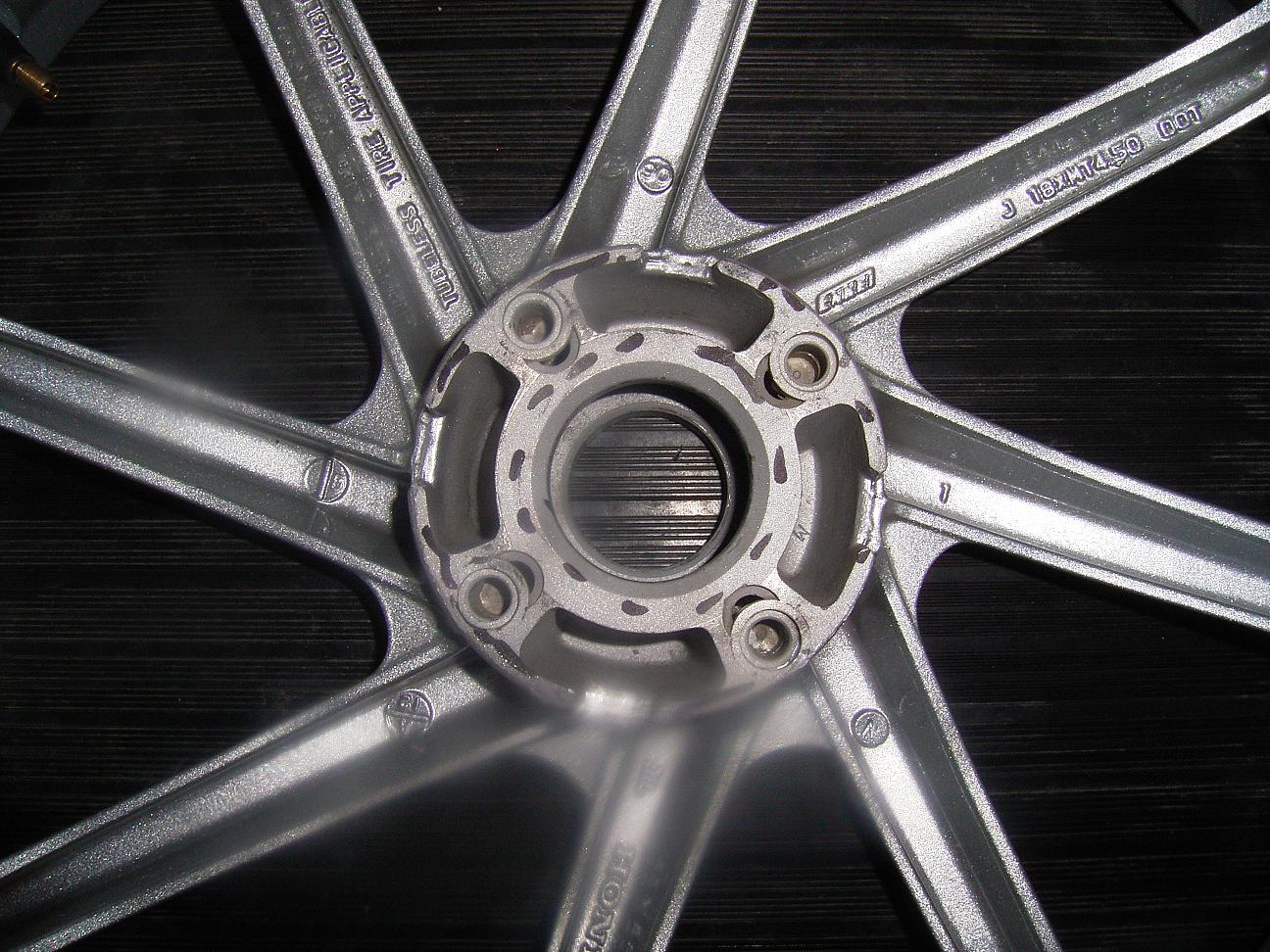

              With the VFR Wheel you have a Problem with the four bolts on the stock spindle or the four holes on the backside of the wheel.
              Here a stock VFR 400 / RVF 400 Wheel
              Here a modified VFR 400 / RVF 400 Wheel
              Or you must change the diameter of the bolts on the spindle.

                      VFR750 wheels, left one modified to fit OEM spindle. Right one had spindle modified so wheel could be used

                        the pictures that dirk posted expline it pretty well if you ask me.

                          I guess I could be more clear. Can a VFR400 spindle (that fits the VFR400 wheel) work with the NT650 swing arm? The picture Dirk posted showed how a VFR wheel was modified to fit the NT650 spindle

                          JR, what did you have to do to the VFR750 8-spoke rim besides filling the 4 holes with weld?
