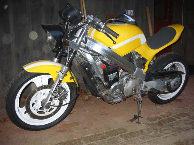

        mine is tucked up on the engine behind the shock.
        fits perfect, and i havent had any problems yet.
        what i did was mount the battery there, then on the RIGHT side of the bike, i put the starter relay. this let the battery to relay wire remain short, and the relay to starter wire was shortened... (thats more weight savings...lol)
        the relay was mounted in such a manner that its battery side bolt is easily uncovered to be hooked to a battery charger.
        i removed the "on starter relay" fuse holder in favor of an aftermarket fuse holder. this let me do two things.... one the fuse was more easily accesible... and two, it let me adjust the wire length, giving me the ability to position the relay where i wanted it.
        the motor turns over faster then stock... but the battery will wear out sooner if you're just sitting there cranking it. simply because it is smaller.
        im happy with where/how mine was moved...

                well like i said im right in the middle of it so i will have more pictures when i finish. but if you look at the one picture the round bar on the frame right above the battery? well its got two threaded holes, i plan to make some aluminum braket to make the battery more secure and give me a place to mount an over flow bottle right next to it. right now its just zip tied in and im still looking for something to use for a overflow bottle the perfect size would be the size of a soda can. hope to get this all figured out and move on to something else soon, anyone got any tricks to changing the clutch without the center retainer tool??? i might have to make another tool.

                  like jay just said above, theres a tube with two threaded inserts in it.
                  my hold down is just thin sheetmetal carefully bent... keeps it from moving up, back or side to side..
                  on the battery i have foam where it touches the engine/trans case.... to protect it from vibration induced scuffing..
                  lightweight but strong... and simple to make.. just need some tinsnips and a vice.... oh and some cardboard and sissors to make the pattern first.
