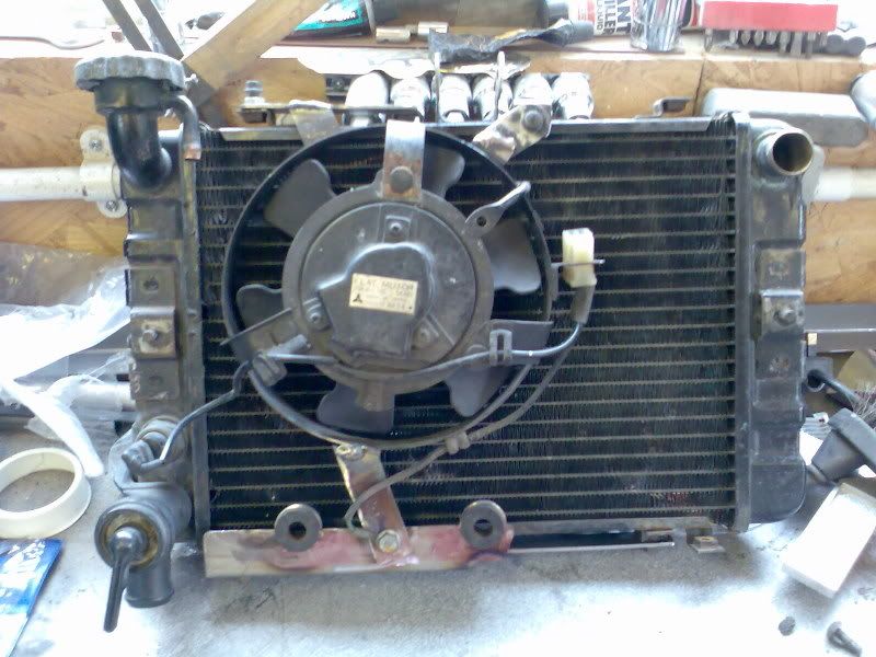

              well heres my efforts!
              welding is courtesy of Rob the blob! well i was outa gas! but it all fits nicely and when i get a new bottle of gas ill tidy it all up and get it powder coated! Bottom bracket gets bolted to the frame 1st! then it all fits a treat!

                  make sure its solid, if it moved it could damage some fins and spring a leak.
                    I figured it out, its a V65 Radiator....any reason why this may not be the optimal radiator? fits the bracket perfectly....
