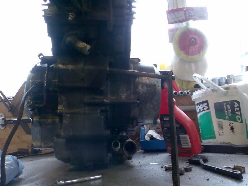

    has any one got any tips how to get this bastard out! both spacers spin, so im thinking its seized in the crankcases, ive had the air hammer on it, wacked the nut side with a dead hit lump hammer, thrown the blow torch and a gallon of pocket rocket at it and still the bastard wont shift! i have spare bolts and spacers so its out with the grinder next!
    Well the bolt is steel and the cases are aluminum so I think its safe to say that the pieces have made friends on a molecular level. If you can find Kroil brand penetrating fluid use that stuff because it is absoutley incredible. If you cannot find a can of Kroil I feel sorry for you because it has so many uses you won't kow how you lived without it. Otherwise you will can use amonia (yeah I didn't believe it either). Fill or continually soak the bolt hole with the penetrant of choice. It may help to turn the bike on its side. If you use kroil it will release within a few minutes of it may take overnight if you use amonia it may take a few days. Hope this helps.
      cant find kroil in the UK any one here know owt thatll do the job?

            yeah i did it back up with the air gun, ive wacked it with anything i could find! ive left it soaking over night and if the little bastard wont shift, its angle grinder time for it!
              well after hours of torching and spraying with oil, i wacked it with the rattle gun one more time and sheard the bolt! least its out?

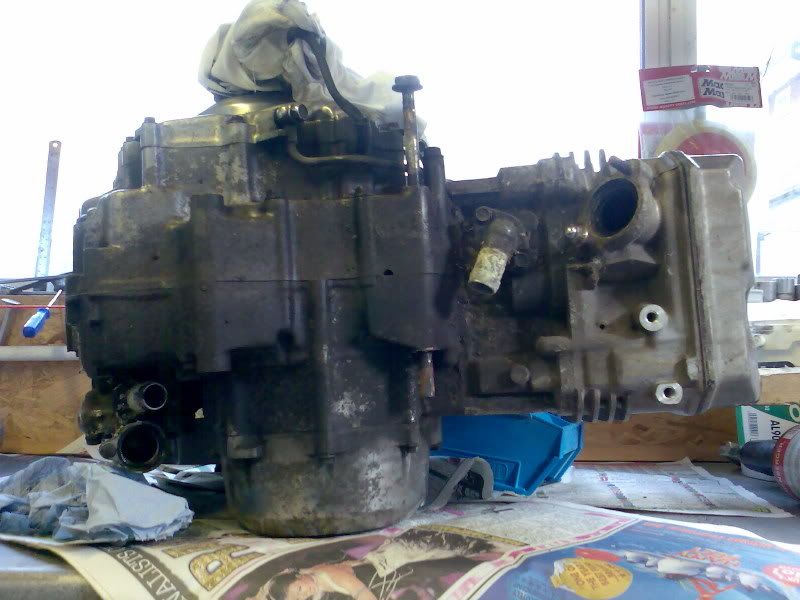

                            after 3 days off heating, wacking,oiling, shaking, drilling,welding and a shit load of swearing! I give you EXCALIBER! well King arthur had no hassles compaird to this bastard!
                            in the end i got some MAP gas for the torch which burns a lot hotter and with a bar welded on the end and an old front header on for leverage, me and me mate finally got it worried and out it came!
                            now to clean the place up again and strip it down!
