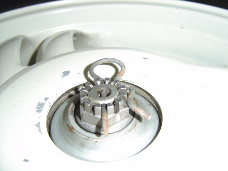

      Yip r-clip and a zip tie.

            if anyone is running an r-clip....take a pic and post it! I don't even know what an r-clip is, but I want one!
              Here you go:-
                oh ok, yeah those would probably work awesome
                  Now flip that R-clip up (In the pic it is laying flat so that the radius in on the nut, turn it up so the radius in on the end of the axle). Now it will be easier to install/remove and hold more securely since now the ends meet. And if you are really concerned about it flinging off you can run a little safety wire or a zip tie around it but I have never bothered.
