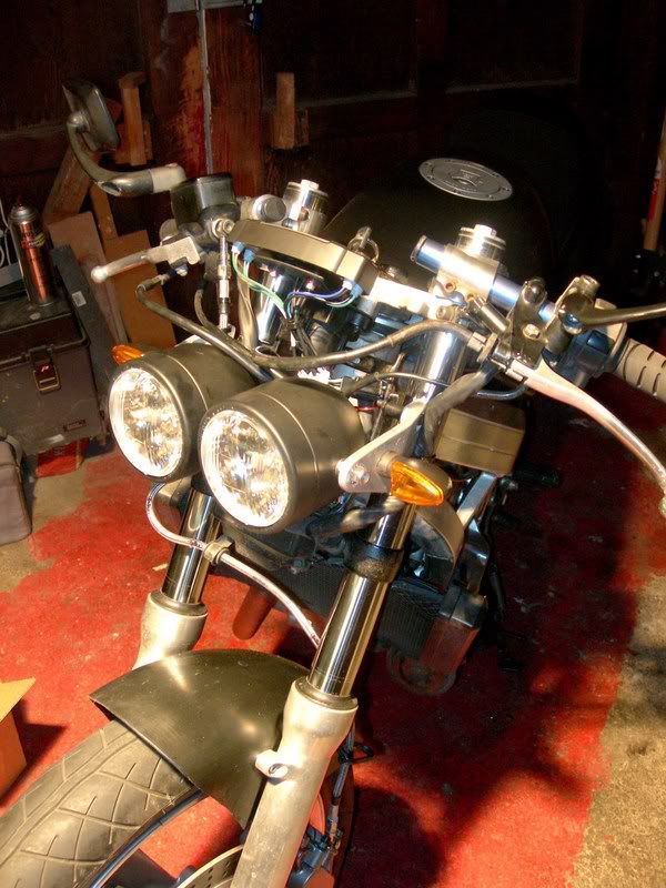

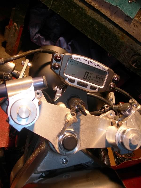

    Finally getting around to mounting my Vapor speedo. Thanks to Steven for the inspiration for the mounting bracket!
    How has everyone mounted their speedo sensor?
    Drill a hole in the rotor? JB weld it right on there?
    Any help would be greatly appreciated.
    Pics would definantely be a plus.
    Also that cable is about a mile long. Has anyone chopped into it to shorten it?

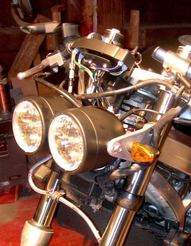

    Well I got pretty far but still have not mounted the speedo sensor.
    I am thinking I am going to have to splice into that thing to keep from having a mile of cable wrapin around the headlights.
    I'll take it for a test ride tomorrow and see how everything is reading.
      Due to the cable being the length it is i put my sensor on the back wheel.
      I will be putting pictures on this weekend of the front end I fitted (twin lights, chrome forks, VFR wheel) so I will put picturs on of the sensor.
        I used the magnetic bolt to replace one of the rotor bolts...put my sensor on the bottom of the fork leg.
        Also shortened the cable... cut, solder, heat shrink.
