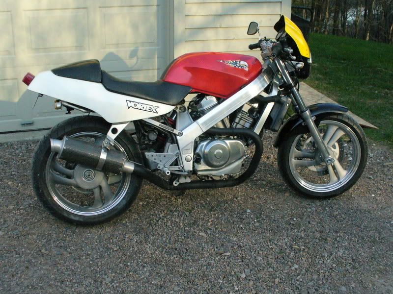

    Wow you sure did alot of work on that wheel! Looks good!
    I did mine with Low Odor Aircraft stripper- it just melts the paint off pretty easy. I did not use any sandpaper- nor did I try to smooth out the unpolished spokes and center of the wheel. The rim edge was polished at the factory before they painted it, and I used a polishing wheel on an angle grinder to shine it back up to a mirror finish. On the unsmooth center section I rubbed in some of the black that results from the polishing, then I coated it with black wax to bring it back to the look of the paint. Just another option. Also I should mention that my wheels didn't have any major pitting issues like I have seen on some of the bikes here in the forum.

            I know this thread is really old,but i plan on doing my wheels soon and this is really helpful,but one thing i wanna know,do the wheels more or less stay like this? Is there something that should be put on to protect the wheel?cheers lads
            My Build here..
              Since its essentially bare save the polish, I recommend sprayed a clear or some sort of sealant to guard against pitting.
              One step closer....
                Don't spray a clear on the wheel. Any clear you spray will not holld up to much abuse and will dull the effect of the polishing. I woudl reccomend waxing the wheel with a good wax and leaving it at that. THis way when you need to do a little polish and touch up you won't have to strip any finish and can just polish with a light rubbing compound and then reapply the wax when done.
