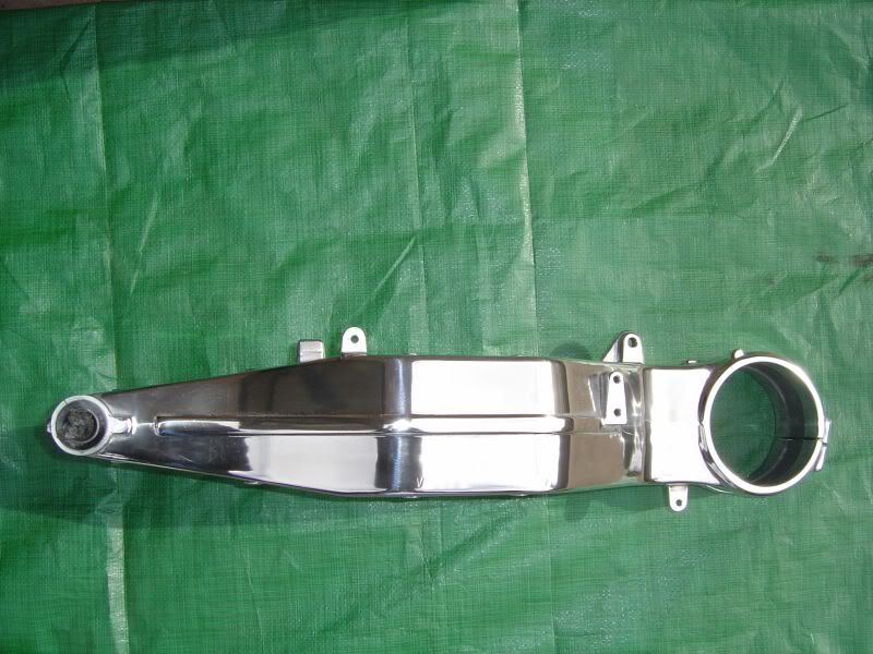

        I polished the wingarm on my ducati.
        You sand it with coarse then fine grit sandpaper then the polish it with rubbing and then polishing compound.... ALOT.
        Much easier with a polishing wheel and it off the bike.
          JR are you sure this isn't chromed! Very nice!

              It is easier to repolish it, so everytime I wash the bike I would use Never dull on it.
              Even better if you get it clear coated (I think)
                Doc,
                no my swingarm is not chromed, but the guy who buffed it to that finish normally anodises parts and if not blemish free shows up in the finish.
                I will be scared to take it out once its back on the bike...........
