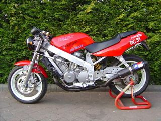

            Whats happening in the pic posted? Are the pipes going in front of the rad? Can you use the stock seat and still put a left exhaust on the bike?
            If I removing the center stand and lead the pipes under the swing arm? or will that cause major cleareance problems?

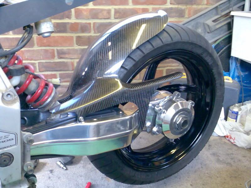

              I had a two brothers left system on mine, the bottom of the link pipe had been grounded and the chain had been hitting it too, so i had the link pipe remade to go up an over the swing arm, so hopefully no more problems!

                  looks very nice..
                    Looks great. I love that chain guard. Is it custom/home made or are they purchasable online?
                    EDIT: Looking closer, is that actually a hugger?

                      Rear footpeg did have a bracket welded to it to mount the silencer but a new one was fabricated by PO, as was the chain guard.
                      ROB321 is a better option as not only do I loose the centre stand but also the side stand has to be moved.
                        yup its a hugger! I think Hord can supply you one!or try http://www.cbr1000rr.org/HawkParts.htm. sorry for
                          JR:
                          -Just that the picture you posted, showed a really good example of a (custom?) left exit system, but no info about what it is or where to get it. I think Kat was looking for something 'bolt-on'. -Just suspected you were a techie as well.

                          I think the Robs321 system is the ultimate left exit system period.
                            No its not a "Custom Home made" exhaust.. Can you see the sticker on the silencer????????
                              i didnt have to read it.. you can tell its a D&D logo from a mile away.. LOL.
