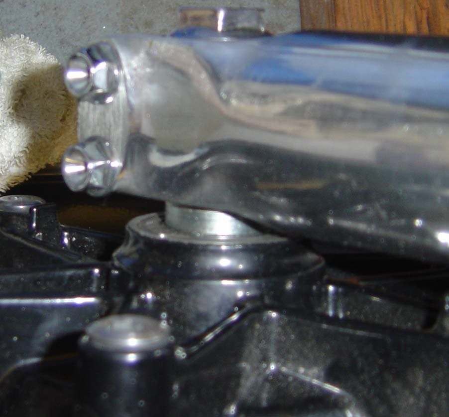

              This is what the spacer looks like when on the bike.
              Hawk Legs with F2 wheel.
              The spacer is req because the F2 wheel
              is 120 and Hawk wheel is 110.
                It actually did have the spacer. I found this out when I went to put the new one in and there was one stuck in the wheel, (I figured it would have came off with the axle) Oh well, Now I have a NEW spacer and a working speedo!
