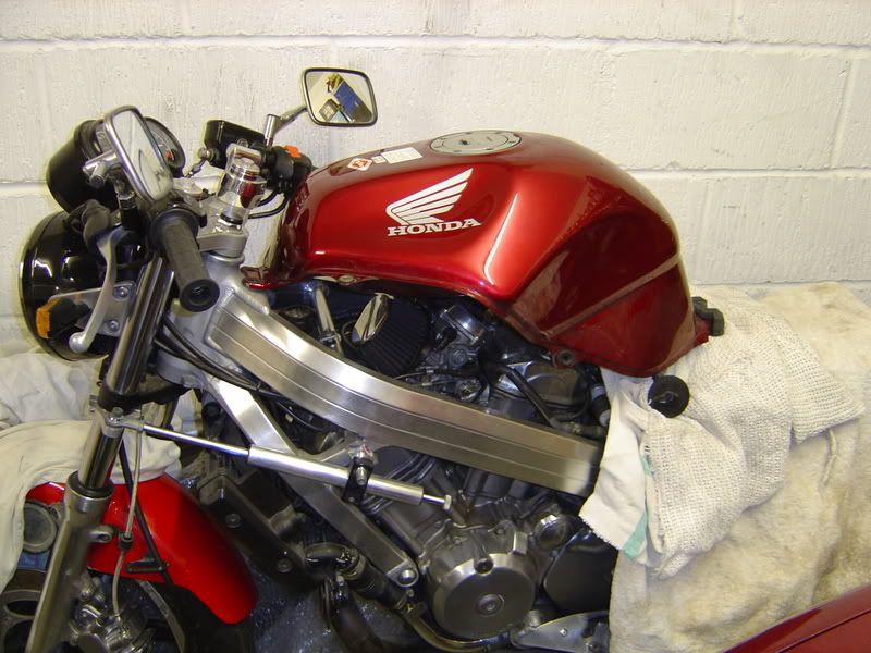

              Whilst doing a sevice on my Deauville, I thought I'd offer my tank onto my
              Hawk to see what it would look like..................errr Bloody horrible..
              Maybe this is why the original lister didn't want to reply
