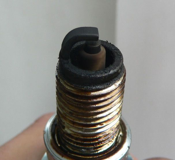

              Ok, I didn't do a full plug chop, but I did take one plug out of each cylinder to have a look... definitely running too rich, the rear a bit more than the front.
              Was thinking of installing a K&N airfilter, or pods (anyone heard of Conical Power? http://shop.wemoto.com/pictures.dyn?u=25327qqq3511569 )... maybe this will help? Might also put a few holes in the exhaust baffle to help the flow.

              Front
              Rear

                  Yup, definitely running rich there. Personally I prefer the pods because of their price, reusability, and it gets rid of that honkin airbox (makes tinkering with things a bit easier).

                      Are your carbs totally stock? Has anyone messed with the a/f screws? Although my only experience is with the 650's, I was always under the impression that settings from the factory were a bit on the lean side and if jets started getting clogged it would even leaner. Then again, I think when I got my Hawk after sitting in some garage for 2 years, the carbs were gunked and the bike was running lean lean, but the plugs looked like yours. How long have you had your Hawk?
