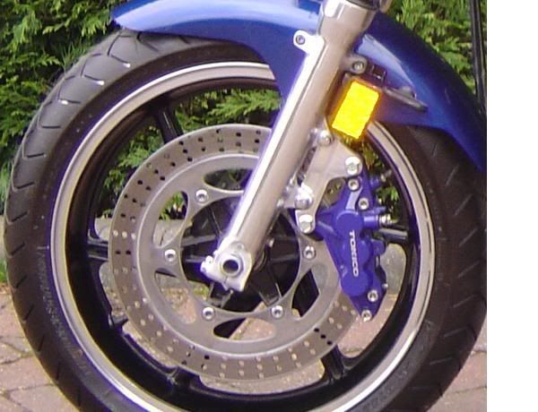

                              Here is a picture of a BROS front end (this one has a Brembo caliper), notice very large lower lug.
                              And here is a Hawk front end (with CBR F2 wheel but with modified bracket to accept a 6 pot)
                              the lower fork lug is almost the same as the top lug
