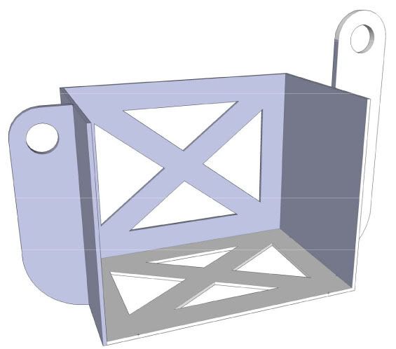

        I'm playing off of some other designs and still retaining the rear coil location and using a smaller Bat than the 7 series.
        I entertained the idea of using the right mounting point of the bottle. Last year I had one snap on me. Actually the frame mount above will provide a much more suitable mounting point + an easier, less complicated connection to the bat box. This will slightly move the top coil mount out the thickness of the material which will be very minimal...

          Nice work Gino.Sweet.
            I was worried about the heat when I first put it there also, but after riding for awhile I put my hand on the battery and it was just warm. I was actually more worried about the heat from the rear header.
