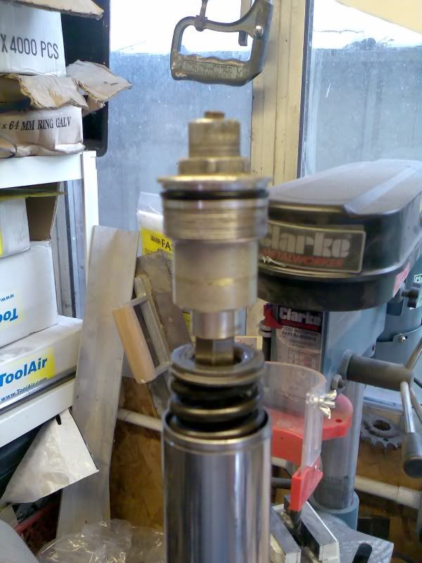

      Basically I want to find out what year of F2 forks that I currently have on my bike and to be able to discern (in the future) the difference between a CBR F2 damper rod fork and a cartridge fork.
      As far as I can tell the all of the F2s had preload adjustments on the fork caps but the fork internals (see above) are not all the same.

        these are what 94 internals should look like!
