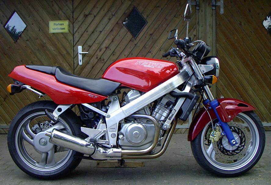

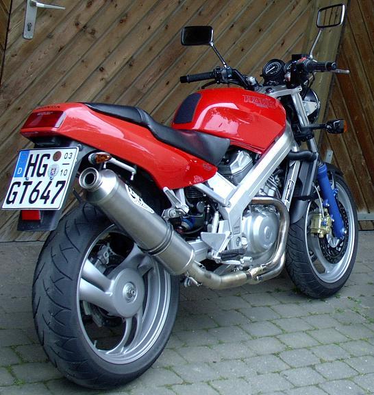

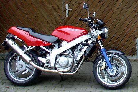

                  Another option I was thinking about would be to put the Deauville
                  front end and wheel.
                  Only because it got the same egg wisk wheel as the Hawk/Bros but is 120, and legs come with twin disks/brakes. And also has the same
                  speedo drive as the Hawk/Bros. Drop in the F3 insides (I think they will fit) and would look good for those wanting to keep a match with their rear wheel.
                  http://www.hawkgt.com/photoalbum/alb...Deauville1.jpg
                  But it is to heavy , i mount it in 2003 and this jear i sold it
                  2003 http://www.gt647.de/HAWKs/2003rot/Ha...22.08.2003.JPG
                  2004 http://www.gt647.de/HAWKs/2004rot/Hawks8.jpg
                  2004 http://www.gt647.de/HAWKs/2004rot/Hawks3.jpg
                  2005 no changes
                  2006 coming soon
                  I only use the Deauville forklegs , disks , wheel an brakes (BREMBO) , the forks are stoke and the Fender is a taken from a Ducati Monster.
                    Dirk,
                    what did you do about the "Dual Braking system" on the Deauville brakes?
                      i do not know it exactly but til 2000/2001 the Deauville did not had a "Dual Brake System" , i use the front end of a 1999 Deauvile with golden 2-Piston-BREMBO-Caliper without DBS , the "Dual Break System Deauville" has black 3-Piston-NISSIN-Calipers with DBS
                      2001
                      2002
