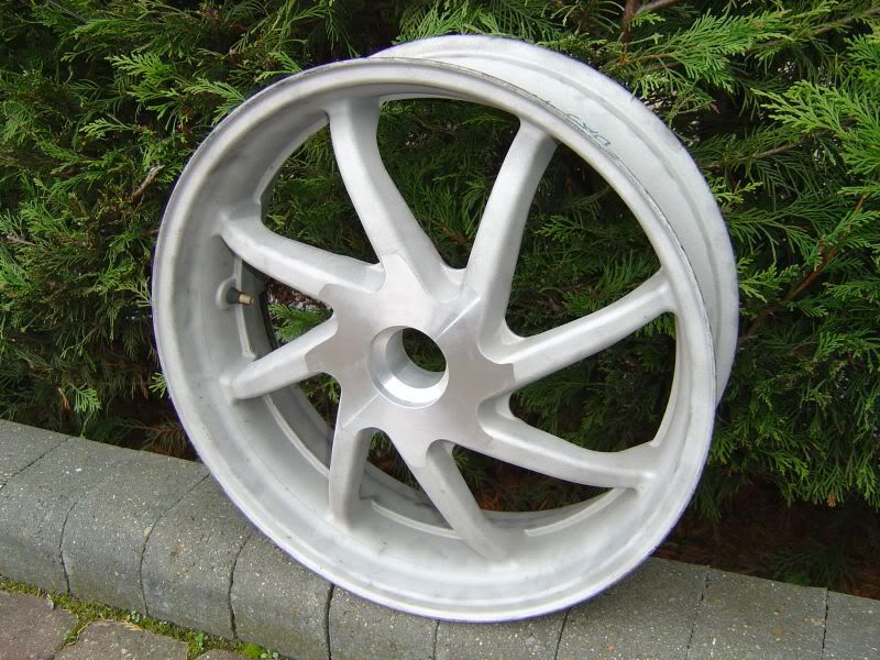

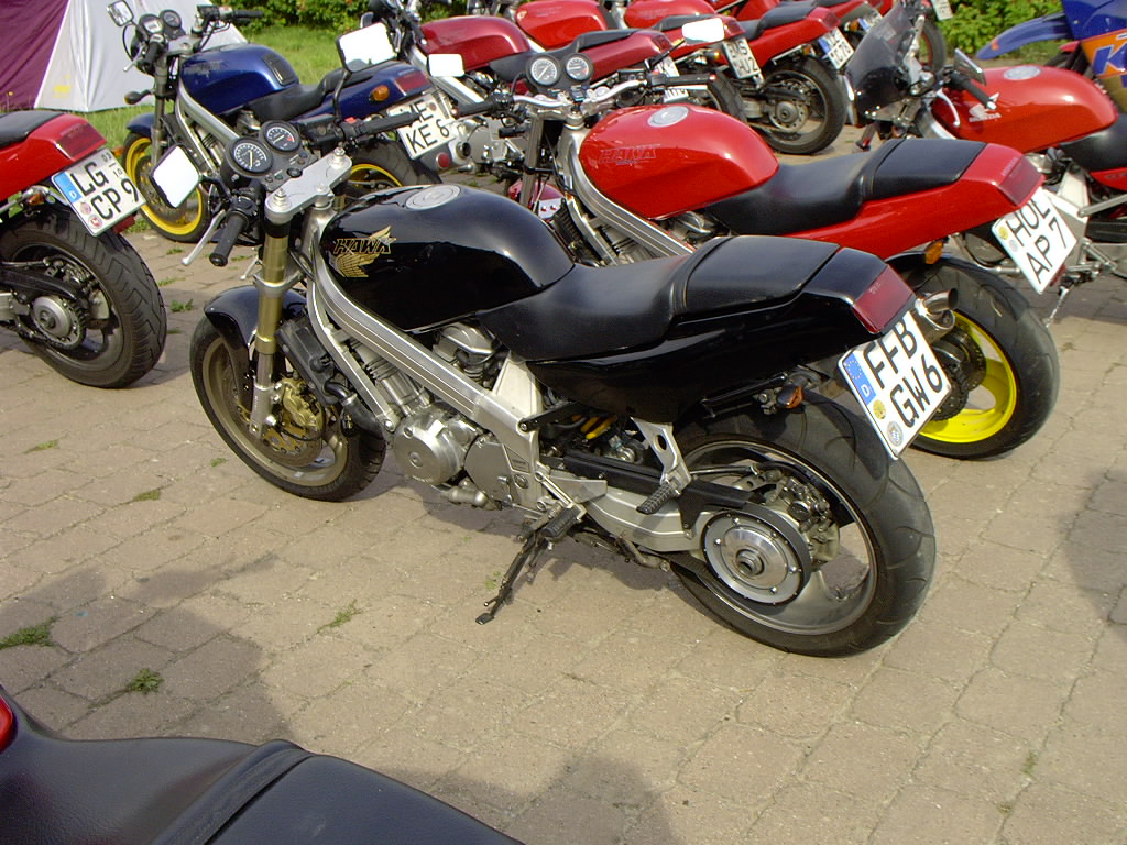

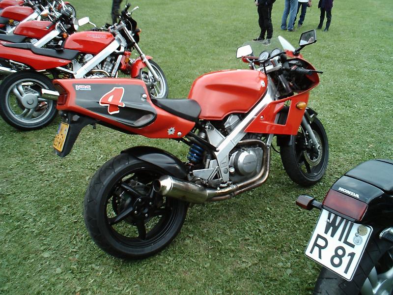

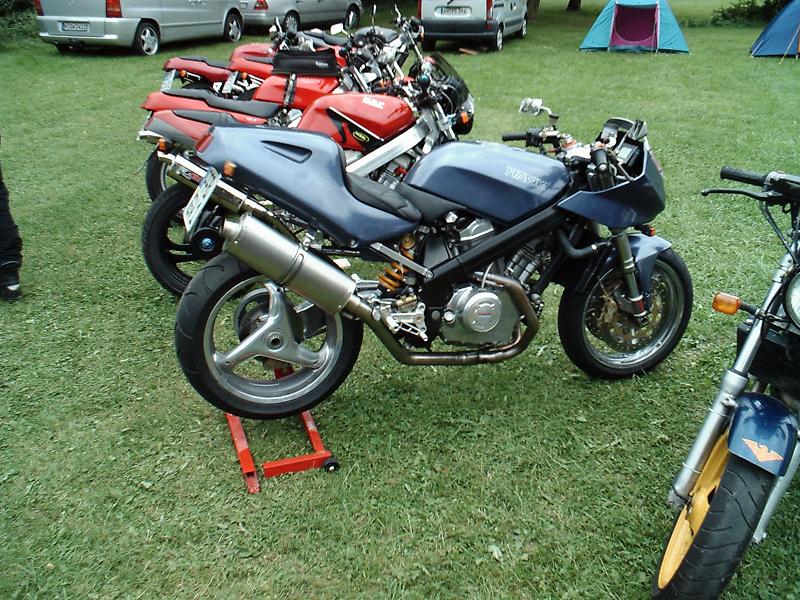

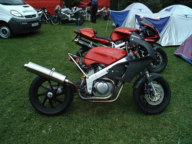

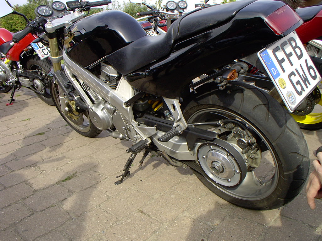

      Well you mentioned the VFR750 wheel so here is one that was prepared earlier
      If you go this route you can fit a 170 tyre, but not if you choose the VFR400
        it is a VFR 750 R (RC30) wheel , 5,5"x18"
        You can also use a RVF 750 or a Triumph wheel
        Ducati
        RVF 400 (4,5"x17")
        VFR 750 F (5"x17")
        VFR 400 R 4,5"x18"

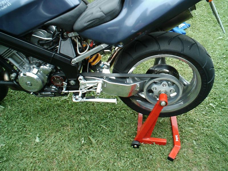

          Thanks for the info guys. Really useful. Like the look of the first Ducati wheel pic best, but guess then I should fit a front end that matches.
          Only just got the bike, so repairs to do first then on to the project this winter.
            First one has a belt drive, too... weird
