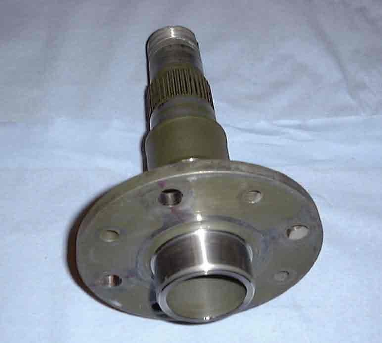

OK I found this :-
The Bros rear spindle needs modifying to accept the VFR750 rear wheel.
I machined mine down as the picture opposite. The spindle was shortened and turned down to 49.8mm dia to fit inside the VFR rearwheel and the 4 holes that normally had the locating pins for the Bros wheel were opened out to 12mm dia to accommodate the bolts for the VFR wheel fixing.
Note: the spindle is as hard as hell and needs special tools to machine it !!

Originally Posted by tjstoneri am able to the spindle mod for you guys for around 50 bucks with the studs installed
plus shipping of course
Do you have any photos of spindles you have done?whatsoever your hand should find to do, do it gladly, because there is no work, love, knowledge, or wisdom in the grave...
Nope...but its on the bike now and i can take a video of me spinning the wheel on the stand.....I am a machinist, its not very hard material at all...its case hardened, once through the first .010" to .020" it cuts like butter....mill out the stud holes with a 12mm endmill......stuck the studs in the freezer for 8 hrs, than i heated up the spindle flange slightly....dropped the studs in, pressed them in slightly with a wheel press...and there ya go...one modded Hawk spindle
Originally Posted by ovlovderOriginally Posted by tjstoneri am able to the spindle mod for you guys for around 50 bucks with the studs installed
Do you have any photos of spindles you have done?Lord Squidward of FloriDUH
