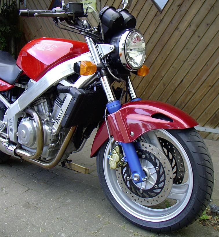

        the one Dirk has in the picture.

            CBR600 PC25
            VFR750 RC36
            CB750 RC42
              Your a font of knowledge Dirk.
              And any one of those wheels will mate with the Deauville brakes?
                ARCIE 31
                Yes , any one of those works with the Deauville brakes ans the speedocable (i hope it is the right word) from the HAWK
