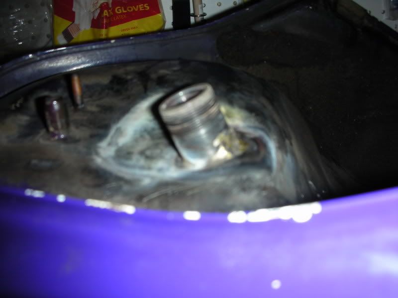

                I have a F2 tank on my bike. Hopefully this will help you some. I'm using a Hyper Form sub frame and tail on my bike though... Now keep in mind, I'm limited to the common mans tools here.
                First I heated up and bent my petcock outlet towards the back of the bike for the correct clearance (valve cover) that I needed. After bending it, I had to fill in a hairline crack just around the base w/ a little bit of brass. I could have avoided this if I would have heated it up a little longer before bending it.
                Here is a picture with the stock F2 petcock screwed into it. I'm using the stock F2 petcock w/out the big plastic knob that screws into it from the factory. Anytime that I need to turn the gas to the off position I just use a small wrench on the petcock instead.

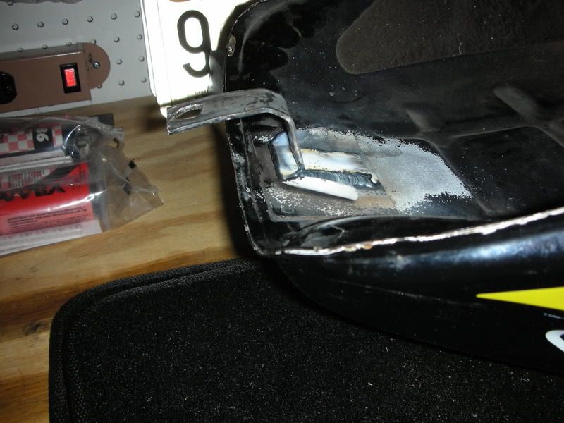

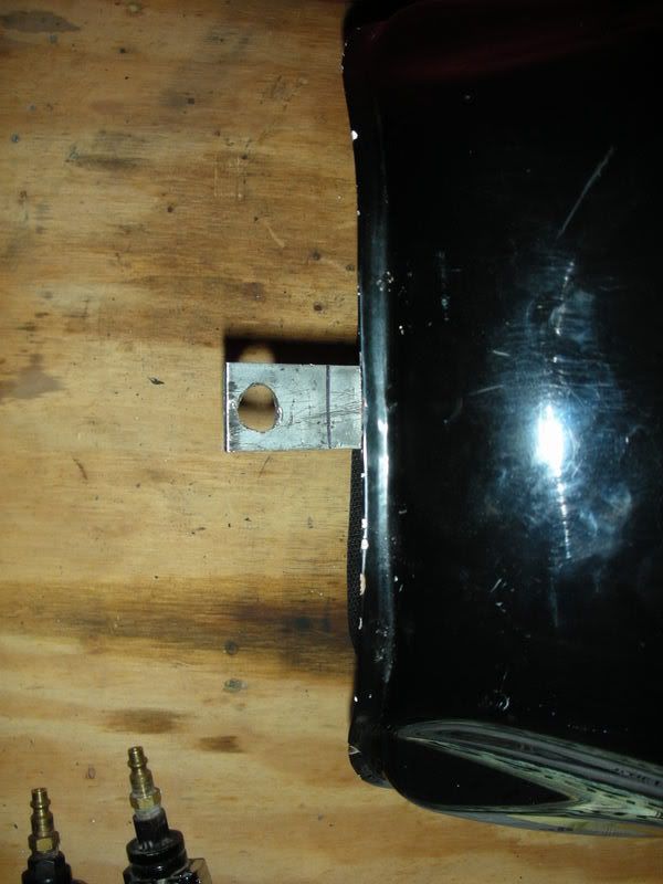

                As for the front tab, I just cut the factory tab off. Then I welded a small piece of flat steel that I picked up at Home Depot on to it and drilled a hole into the end of it. The piece of steel that I used was about 1 1/2 inches longer than the stock tab. It took a little bending to get it right but no big deal. I'm even using the stock hawk rubber piece on the end of the tab.
                Here it is on the bike.
