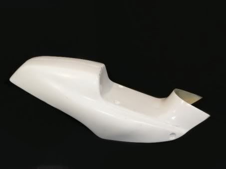

              If you want to keep the Hawk original look then how about this baby...??

                  That pic: What is it, and where is it from? That really looks good if a solo tail is what you are looking for.

                      Well its a racing single seat cowl for the Hawk. It comes with no hole for the rear tail light. However I've been told its easy to create a hole.
                      Here is a picture of what it looks like on the Hawk:-
                      I haven't got it yet as it is made in Germany/Czechoslovakia
                      I might treat myself to an early xmas present.
                        It arrived in the post this week:-
                        [/img][/url]
                          That looks real nice, any website/info on the supplier or manufator?
                          I might pick one of those up for the track bike depending on the cost....
                          looks like it works nice with the stock tank and subframe.
                            You can mount about anything on the stock subframe,especially if you trim it behind the seat latch-but you do have to make spacers and DIY attachments.Airtech and Sharkskinz still make the RC30 and RS250 Hawk tails but many others will work with some creative bracketry and trimming around the tank.The main issue is really how it fits on the tank and much you mind or don't portions of the subframe are exposed.The Hawk seat and cowl fit much lower than any sportybike so you have to adjust for that.FWIW the Hiperform tail would look bizzare on a stock subframe IMO as it's so thin,almost the entire lower subframe spar would be exposed and it'd look kinda strange.
