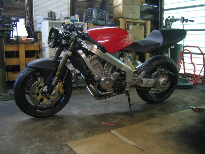

        I got a small square nalgene bottle, wrapped it in aluminized heat barrier, behind the rear cylinder. doesnt look to trick, but my battery is tucked out of the way now. Tyga sells an HRC kit to do the same thing.
          You can see it peaking out behind the frame rail.
            This is the one that ovlovder speaks of, it looks pretty good:

            1988 Honda Hawk GT
