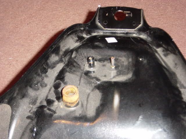

    I just got my f2 tank. Does anyone know which line is which? And I heard one was a vacume line. What do I need to do with it?

    Considering you have a Hawk, which has a transfer pump for the fuel, you don't really need to worry about anything but the big one. The way mine is hooked up is just a big hose going down to an adapter that goes to the fuel pump. The two nipples at the back are vents so the tank doesn't collapse from the suction of the pump. When the tank is upright, those vent so high in the tank that they don't leak fuel.
      thanks for the help.
