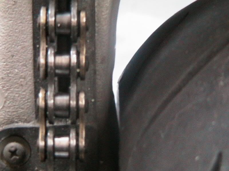

              180/55 tires will clear the swingarm - almost.
              Dunlop 208's on a VFR 5.5" 5-spoke rim: (looking down at the ground)
              The swingarm needed just a little bit of assistance fron a half-round file to give some running clearance. Not significantly weaker, as the casting is at least 1/4" thick there.
              The 180 rear is just for looks, not needed by a bike this size.
              Scott is right, different manufacturers vary in size away from the theoretical numbers. A Dunlop 180 may actually measure 175 to 185 across the outer edges.
