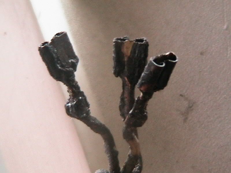

            Isaac: does this look familliar?
              Re: It happened to me too!!
              Yeah that's it alright. Goo all over, dirty, and broken apart.
