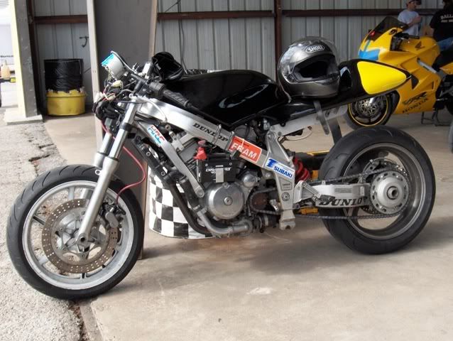

                here's mine.
                Fibreglass over foam. The guy I bought the bike from made it up. I ended up drilling holes for bushings and bolting it directly to the subframe.
