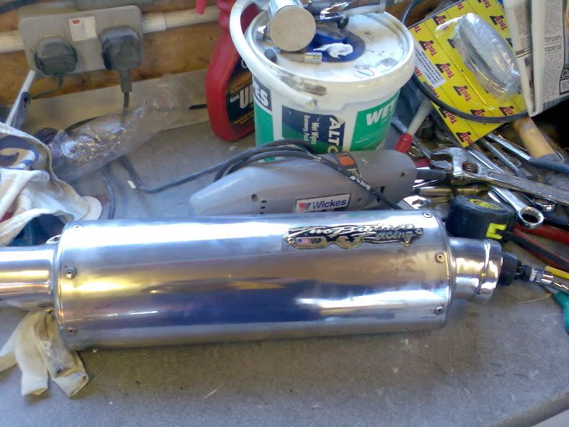

    i have one of these!
    ive just sanded all the scrapes outa it and wanna polish it but id like to strip it down so its easier and also get the badge re enameld or chromed etc! is it a case of just drilling out all the pop rivits? also i wanna repack it while its apart!
    any advice?
    That is correct, sir.
      use a drill bit that it the same size as the rivet head.....some people try to dril lthe rivet out itself...but just drilling the head is so much quicker...and sometimes you can even grab the leftover without it falling in the can

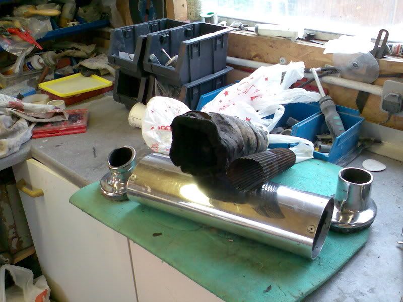

        voila!
        shiney pics to follow!
          ya you look past due for a repack that looks black all the way throu
          i like when they get like that the sound is louder
                yeah, thats why i wanted to strip it! cant be doing with being pulled by the plod every 5 mins(yuk yuk) so ive ordered some new packing and started the polishing!
