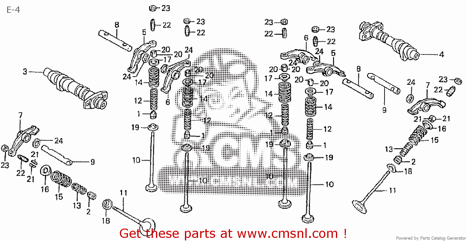

    This maybe a dumb question, but are the nut and bolt used to adjust valve clearances on the BROS 400 a generic part that's interchangeable with any other bike?
    I've got to adjust mine and for some reason that I've never seen before, they're all badly damaged threads and the nut is basically locked in place on a few of them.
    I tried taking a nut off to see if I could re thread them but it just tore the thread to pieces taking it off, so I'd like to just replace them all
    Given this bike was never released in my country I thought I'd see if they're interchangeable with any models that were released here first

      The nut and bolt WILL be generic across many models. I can guarantee that even before researching. They will even have the same or different part numbers depending on model/year. I have sourced many parts for my 650 that are not my model or my year. EG Cam chains, Cam chain guides, Cam chain adjusters, Piston ring sets (Off a VT750), all bearings, clutch thrust plate, etc etc. I will research and come back with availability. NOTE 650 and 400 have the same parts....done SCREW 90014-MF5-000 $2.55 NUT 90206-590-000 $1.16. Both on MANY hondas and both available from Webike Japan. (A staggeringly fantastic site for bike parts)

              Thank you. I had checked the sites I knew about like wemoto, but hadn't heard of cmsnl. Looks like they have a lot of other stuff I need too.
