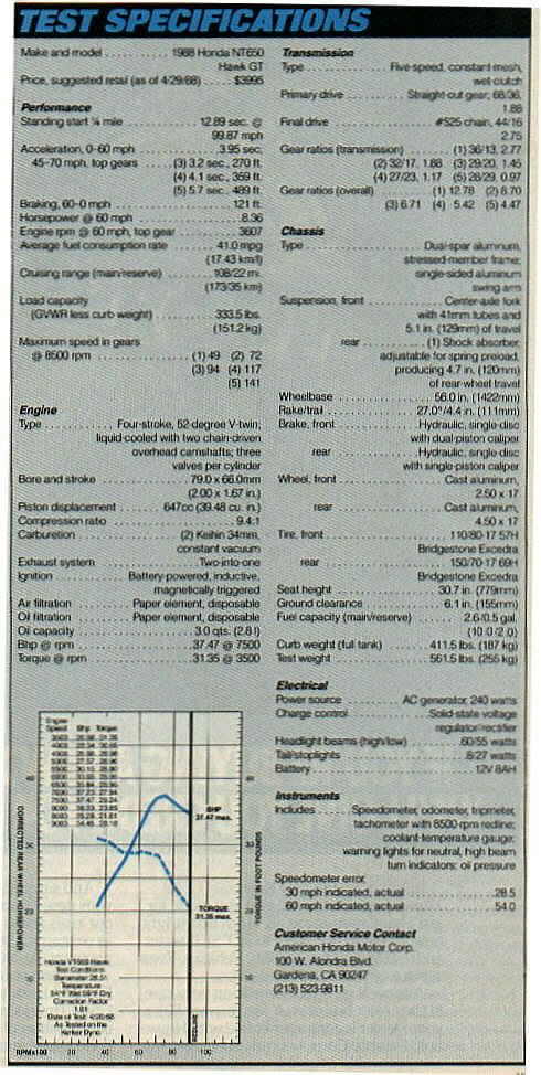

    Ever since I first saw that 38hp number I've taken issue with it. Is that measured at the rear wheel? What is it at the crank? I'd guess 45 or so.
      Bump for open debate on the accuracy of these specs.
      I was looking over the gearing numbers, and I know my bike sure as hell doesn't top out in first gear at 49mph. It might be closer to 40mph. My bike will redline in top gear at right on 120mph. That's with a stock rear tire and taller gearing than stock. Nevermind if it were actually stock.
        Ive got a print out fro a 90 hawk 650 that says 58 bhp @ 8500 rpm. you can see it at www.arnold-talmon.com/images/hawkspecs.jpg

          Nice link. Those look like a lot better specs. Kinda interesting that it says the stock chain is a 530 and that the top speed is 1mph higher than the mathematical redline. Otherwise those look like really good specs. I'm gonna have to redline my bike in first to see if that gear really does go that high. That's nuts.
            I don't know of any stock Hawks that will do more than 110mph with ANY change in sprockets. Am I wrong? JD?

                    Seriously, I agree with Doc. A stock Hawk GT engine is not as powerful as you're thinking. I do seem to remember, though, that it's actually 48hp, not 38. Ah, whatever. They're fun.
                      Considering I said I thought it was 45hp, and J.D. Hord dynoed a stock one at 45hp, then according to your number it looks like it's more powerful than I'm thinking. I dunno about Pauly's number, but it'd be nice.
