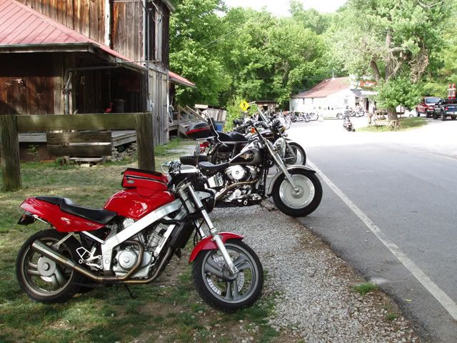

          It was definitely a slide... I started into the turn and as I rounded in like the previous several, this one suddenly got really tight and I leaned further into to it without changing throttle at all trying to keep from straying into the other lane; my fear was that I was gonna slide right out and take out suzuki boy at the same time. I never thought about the ground temp - doah! - it was pretty damn hot and sunny out and a lot of the road was in a canopy of tree cover that was on and off. Hmmm... that just may have been it. I'm just sad that i was dragging my foot and still had some tire left (me and my dumb big size 15's!). Really great ride, though! Came up with some pics... need to get a mount so I can get some through the curves.. (yeah, I know, hanging out with a bunch of Harleys.... my friend's crazy though, and tries his best to hit the curves hard and fast ... I think he's taken about 1/4" off of each of his footboards... haha... and I don't know anyone else with a sportbike...)
          Don't make fun of the center patch - I gotta drive on a bunch of expressway to get anywhere. I live in the boonies.
          Cruisin behind my friend on his Fatboy...
          My Hawk hangin' out with a bunch of other V-Twins. If you look, I think you can see drool coming from some of the H-D's mouths!

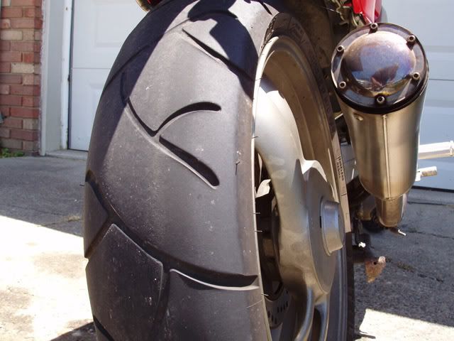

            It might actually be the center patch on your rear and the transition when you leaned in really hard. The tires that came with my Hawk had a really bad center patch, and were pretty much bald all the way around. When I'd lean into a turn I'd get a weird wobble at the rear as it transitioned off the center patch. A new set of Metzler M3 have cleared it up.

              Looks to me like the centerstand hit and levered the bike off the tires. It's obviously ground down. Time to ditch that and/or get a Penske shock on the back!

                Good point JD. I hadn't thought of that but that would do it.

                            By looking at the pic of your rear tire you are way underdamped. You need to pick up a new rear shock. I have an Ohlins. Ohlins and Penske are going to be your best bet. I weigh about 155 and have never slid my bike. At track days I'm keeping up with all the modern bikes in the corners and am starting to drag other parts on the ground. (My stock headers on the right and the kickstand on the left.
                            I would agree with Hord that you were dragging the centerstand, that was one of the first things that I removed.
                            Here's a pic of my tire - 160 BT-014

                              Well, first off, I changed out the Metz with a Pirelli Diablo Strada in back... I have come to realize the the m-1's that were on it are VERY hard... maybe it sat a while before I bought it??? So the Pirelli has made quite the difference at least in how confident the rear end feels. I've ordered a front matching Diablo and expect the same results from that. I am also ordering either the Penske or the Progressive shock(I'll likely not be doing any track days or other racing). The front forks do have Race Tech Springs but I have no clue as to the specs. Is there any way to check? I would say making the suspension right will be the biggest improvement.
