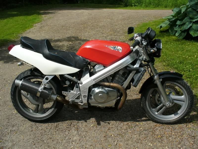

    I got a VFR wheel and ceramic coated my exhaust. What do you guys think?
    looks nice...
    i especially like that solo tail
      HOT. I can't wait to get my seat cover in the mail!!!
      Nice job modding that exhaust. I LOVE the ceramic coating... matches the ally frame beautifully. The shorty can is perfect.
        Looks great! Did you ceramic coat the exhaust yourself? I did mine in the oven... kinda stunk up the house for awhile but it came out pretty good.
          How do you do it yourself? I will do it to mine if it's easy enough, my headers look bad
