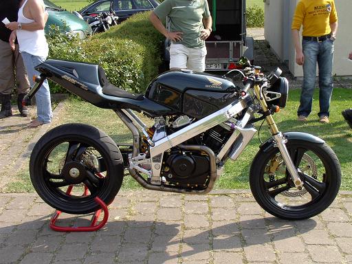

    On the HAWK - Meeting 2005 in Germany , we can to marvel a very nice BROS , the owner is Jochen Pohle , he wins two Selfmade-Contest in two big german motobike magazines.
    Here some dates :
    cubic capacity = 839 ccm
    power = 85 hp
    wight = 155 kg with oil and 16 liter gasoline ( i donīt know it in lbs an gal )
    tyers = 110/70-17 on 3,15" x 17" / 160/60-17 on 5" x 17" , the original BROS-wheels are broadened , with Bridgestone BT 090 ( a very good tyre for the HAWK )
    ...and many many more modifications
    does anyone know where that tail section and subframe come from? that is by far the coolest looking tail end I have seen on a hawk.
      It is all selfmade !!! Sorry

            Wow, that one's just 100% perfect. Wonder what model the engine's from - it's not the Hawk's, but it is a V-twin.

              Doug I would guess that it is an XRV750 with the Africaqueens 840cc kit. Check out the "motor swap" thread for more info.
              Blade.
                Thatīs the original BROS engine
                Take a look
                If youall want bigger puctures of the BROS , send me a email. [email protected]
                That is a XRV750 engine
                You can see it at the different enginecover

                    I've been reliably informed that the seat/tail was from a Cagiva Mito thats
                    had alot of work done to it

                              But the weight seems a bit on the low side for what has been listed, 155 with 16L fuel would be sub 140kg dry, sub 310lb with stock rims? I want to know what else has been done!
                              Cylonbros
                              Parts: CBR600F4 shock, mikuni fuel pump, givi screen, ZXR250C USD forks (front -15mm), renthal fatbars w full diamond grips, ti exhaust wrap, uni pods, factory 3.0 jetting, mumble V seat, shorai LiFePO4 battery
                              Custom Parts: linkage (rear +30mm) and chain roller, pump mount, fork swap fitments and risers, caliper mount wing, frame sliders, ally subframe (-10kg), in-tail exhaust, battery/cdi/reg holder, hugger/chain guard, cowl, tail light, tail tidy
