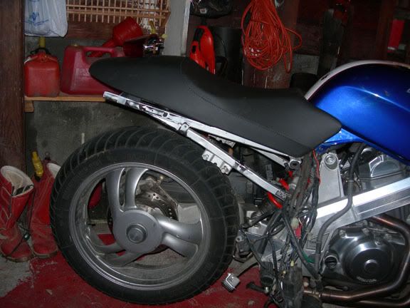

                    I have started the project but am allready a little unsure.
                    I am not 100% sold on what seems like will be the ultimate ride height. Being of the shorter stature I liked how the hawk sat low. The monster seat I dry fitted here seemed like it might be a bit high.
                    Anyone else come across this yet?
                    Looks like I am going to use a monster tailight but possibley invert it and mount it deeper under the seat. Gotta figure that one out still.

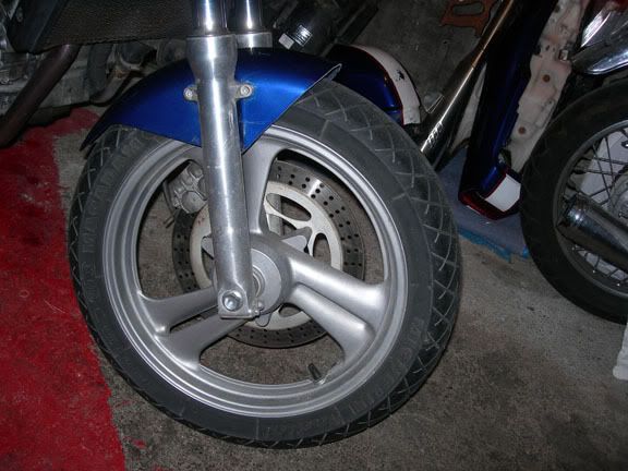

                    Also I got a wild hair with the dremel and chopped off the front of the fender, only time and a little rain will tell me if I am crazy or not.

                      Trim the seat foam down and have it re-covered? That should take care of the height. As for the front fender... whoah, man, that's trimmed back farther than mine! Now, how about that back part?

                            I figured out the seat height. Sometimes I get a little crazy with a torch and a utility knife. So i just cut all the extra nubs from the bottom of the seat and filled in the holes with epoxy. Now the seat hugs the tank right and I have my ride height almost all the way back.
                            I asked everyone I know how much front fender you need?
                            No one had any math or answers so I just did what looks right, well to me anyway. I am fairly sure that at least for the riding I do it will work out fine. If not I never liked the fender anyway and will try and find a more interesting alternative.
                            Stay tuned..........You never know what other stupid shit I might do.
                              Beauty is in the eye of the beholder.
                              Maybe if you cut the back piece to match...
                              Didn't mean to offend, It just looks... too sharp?
