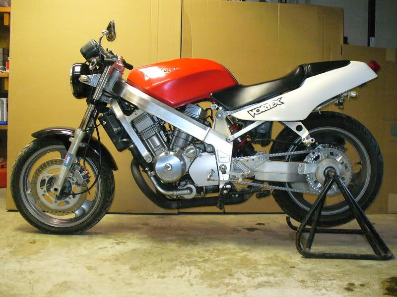

      that seat looks comfy but... UGH! it's so ugly!
        hmm I would have to agree... kind of a frankinstein looking rear end
          That seat is gone! (replaced with a stocker) I would like the corbin solo, however! Since this photo I have cleaned up and ceramic coated the pipes, added a Vortec chain and sprocket set and replaced the somewhat bent clip ons with some nice german ones I picked up off ebay...

              The Gunfighter and Lady _is_ an eyesore,but if you're planning on doing some Hawktouring I'd highly suggest keeping it.The stock seat foam is dreadful and the hideous rear butt well of that Corbin makes for a great place to set your saddlebags: it's actually one of the best ways to carry such things on an NT,and with em on- the hideosity is concealed.

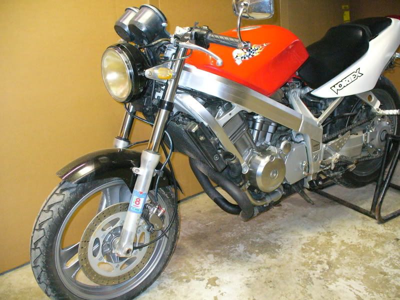

                Here are the latest pictures- where I am so far: added vortec chain and sprocket set, ditched the ugly seat for a stocker and ceramic coated the pipes:
                  Looks much better imho
                  Now about the paint... I kinda like the mismatched rat bike look. Suggestions?
                    Hey that oil leak could be coming from the drain plug....
                    I say paint the front fender white and leave it like that.
                      Do that poor motorcycle a favor and put some slack in that chain. Good god man!
                        You noticed that too! I didn't know it was supposed to be adjusted with weight on it... and I no longer have the little gauge so I was winging it. Any ideas on how to set the adjustment without the little gauge?
                          I found a picture on the net where someone had placed a scale next to the stock gage. I'm thinking A is 35mm from top, B is 45mm and C is 55mm. So if you lean over your seat and compress the rear shock as much as you can then push the chain down it should be more than 35mm from the botom of the swingarm and no more than 55mm. I have a fox thats raised a bit so my chain hangs out way loose, just under 55mm
