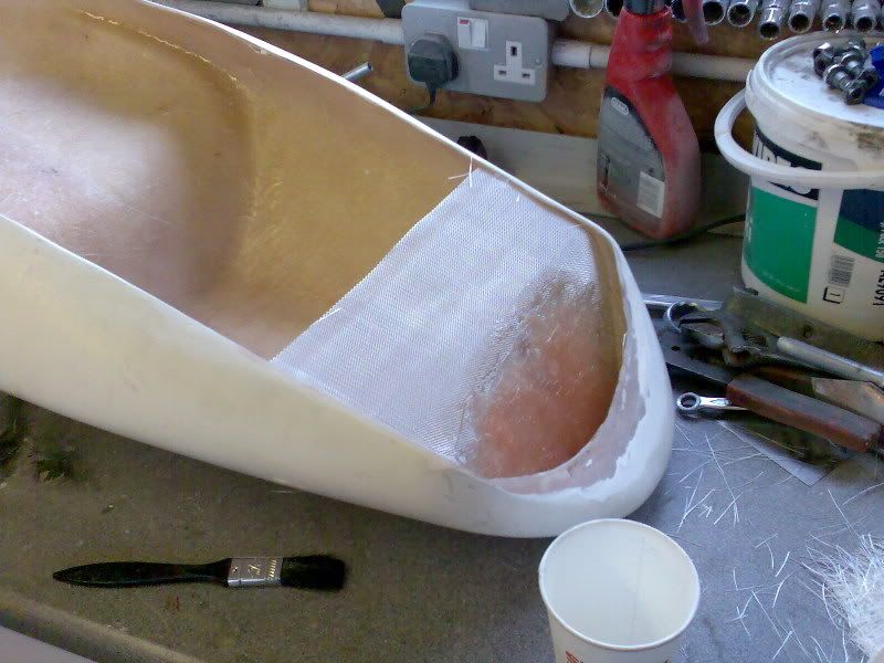

    i got my tail just after xmas and decided the underseat pipe look wasnt for me! so i decided to fab up the rear end to take some lights and number plate brackets! how am i doing?
    theres still plenty of sanding to do! i was not impressed that a load of the gel coat came off just by dusting off with the airline! so ive had to flo-coat a lot of it to fill the holes but thats just a minor worrie when you own a dog of a bros like me?

      its not a hard job to do, i got some aluminium gauze from a motorfactors what they use to repair rust holes. then its just a case of laying on the fiber glass and wetting it in. decent flo-coat helps smooth things out! but there will be plenty of sanding too!
      i held the gauze in place with a few dabs of hot glue!
      make sure you overlap plenty of matting underneath fo strength!
